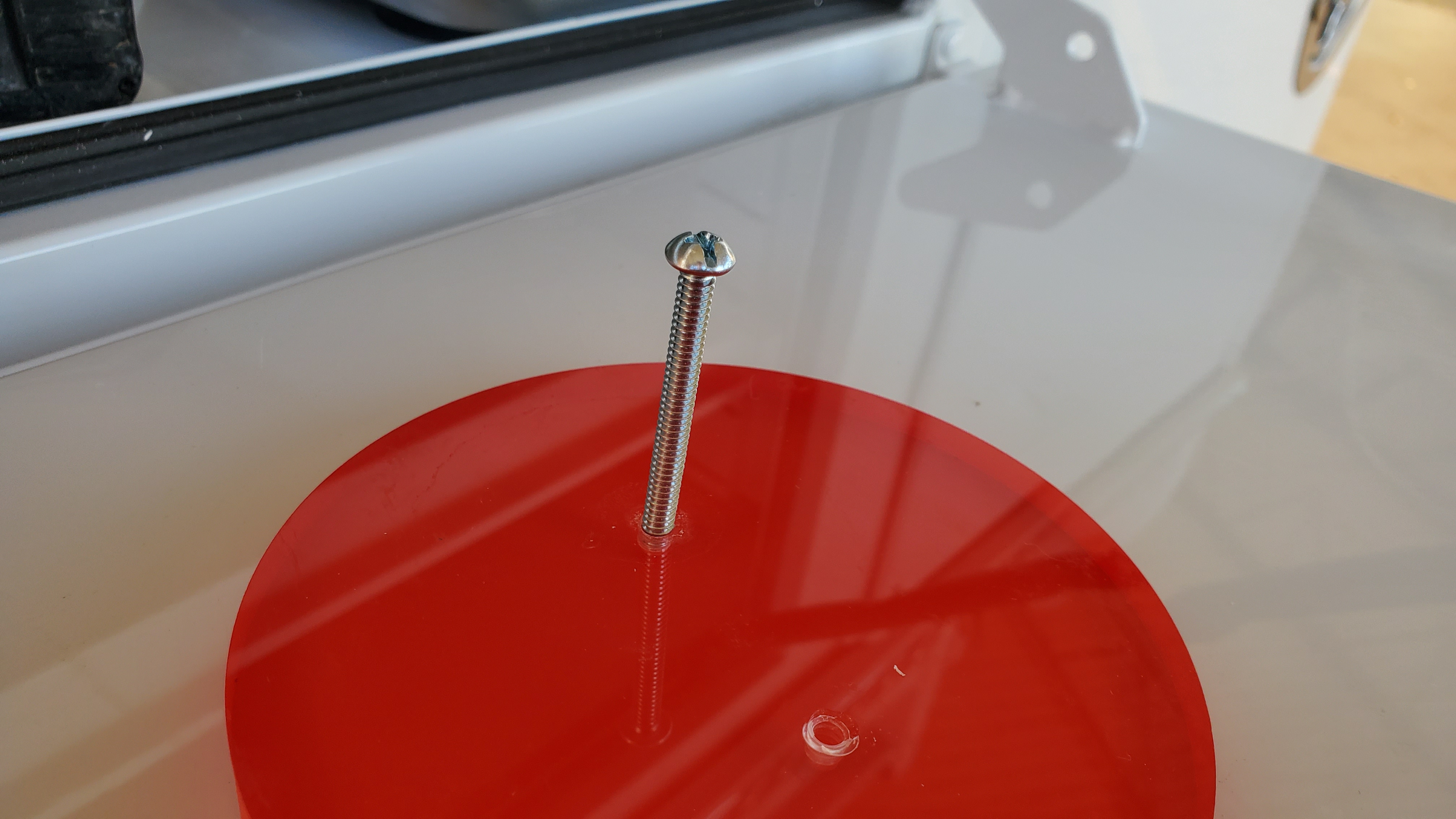

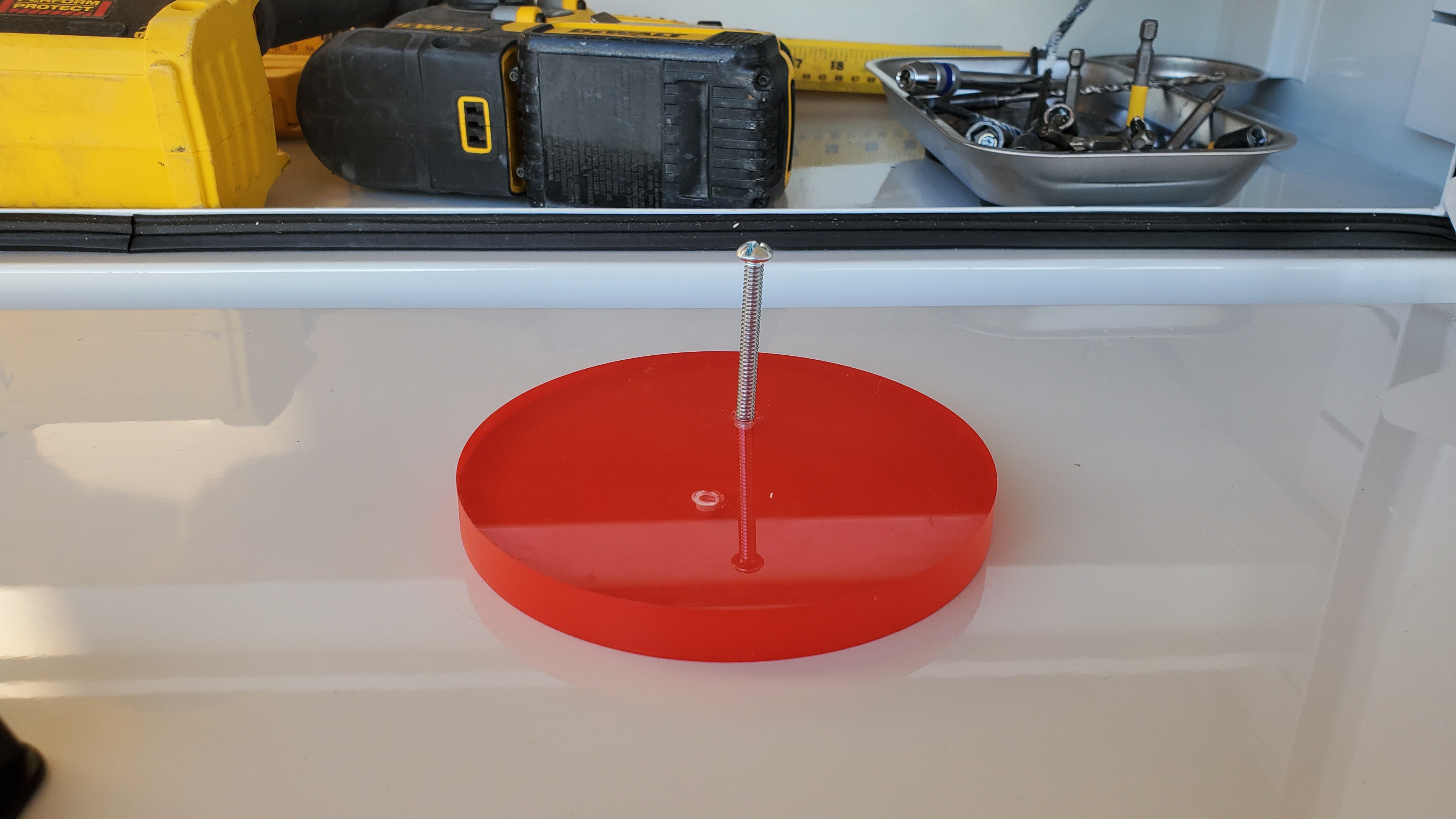

Gemini studs in a pinch

we use a cold saw and clean up with a grinder.
make sure the all-thread is at a 90* to the grinder and you can use nuts after cutting
The pre-loaded bolt is very helpful, just tedious if you have a lot to do.
cutting on-site, a pair of flush cut bolt cutters are handy or a grinder with a cut-off blade
