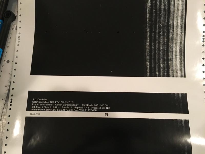

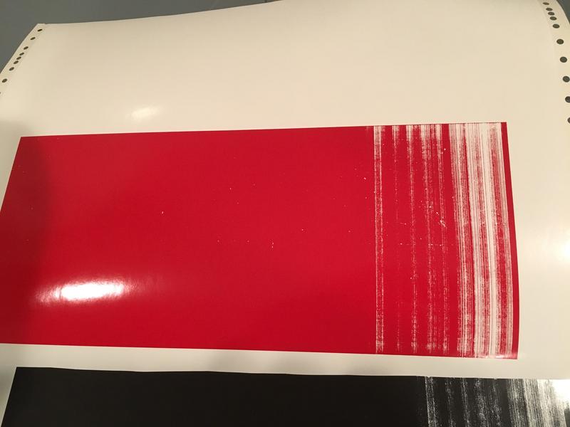

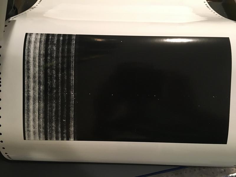

Hello all!
well, now MY Gerber Edge 2 is acting up. ( something in the air SellersSign?
Stats: 14K minutes. Has always printed perfect- until turned on this evening. bummer- this is my favorite ( I own a few LE units).
Symptom: Hazy print on block test pattern towards the top --It is inconsistent - or shall I say non- repeating.
I have tried:
1. different vinyls
2. different foils
3. tested print with hidden key
4. tested print with Gerber Omega - ( 6.0Cp) just a simple 11.6 or so wide block.
5. pulled side covers, re-seated print cable, and all others I could access.
6. cleaned all dust out. - very little.
7. pulled top cover - all connections, capacitors look good.
8. (I have not checked the actual cable to print head connection)
9. tried different outlet circuit and power cord.
It printed a little better with the sent file.
If you are a Gerber owner - and seen this before, please let me know your thoughts. Thank you in advance!!
