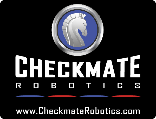

The attached is the desired result (a 3 x 4 label). I was going to print on the black vinyl because I like the matte black finish of this vinyl. I guess I can try rearranging the print order as suggested. The main issue I was having was the round logo was a jpg image and I had issue where when I tried to print in one layer on a white vinyl and adding the black was the jpg image would block out a white square behind it.
Thanks

Printing white on matte black vinyl produces some interesting, artistic effects that might not give you what you want for these decals. Four color process printing on the Edge leaves something to be desired (my opinion) especially on relatively small decals like yours. You might be happier with the end result if you convert the image to spot color vector art. If matte is absolutely necessary, consider printing on gloss black and laminating with matte clear. There's my 2¢.
