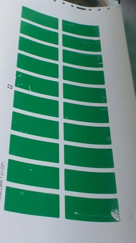

I've not printed with the Edge FX in over a year but as I had some labels to print this weekend, I decided to give it a though clean before printing.
The vinyl & foils I'm using are also more than a year old but have been stored in a clean, cool place.
This was my first print:
attachment.php
Quite horrible!
So what's causing this mess? Before printing I'd clean the head with an alcohol swab and all the surrounding areas.
Any ideas? Do these machines benefit from being left on a while before use?

Looks like surface contamination on the vinyl. What do you get if you waste the first turn on the roll?
You might also want to create a block that's 11.75" tall by 3" wide with a spot color fill and save it. Then use it as a first print when you've just turned the Edge on. This helps to get everything firing and heated up before you print something larger.

Thanks Fred, I did wonder if my vinyl might be the culprit. I've placed an order for some new vinyl and foils.
I'll also try what you suggest with a solid block.

Interestingly, the print is a lot better (not perfect) if I print 600 x 300. I'm guessing there's a reason for this :/
stitchup
Resolved by printing 600 x 300 :)
