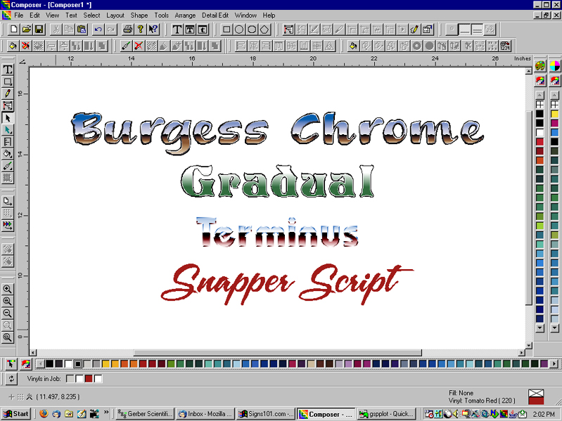

Fred when you say you prefer process color for most jobs is that with the gerber edge or are you talking abut something else. And can you use flexi software with the gerber edge? Why dO I see people selling fonts for the gerber edge. You can't use regular fonts off your computer. i am confused. Please reply Thanks Karen

It sounds like you have a fair amount of misinformation Karen.
Yes i am talking about the Gerber Edge. I print from Omega and have printed from Flexi but do not print from Flexi on a regular basis. I'm unfamiliar with an aftermarket offering for Gerber Edge specialty fonts but it would make sense. These are fonts designed for use with the Edge and about a dozen are supplied with Omega. The attachment below shows a few of them along with a non Gerber font from our own Steve C's offerings which I typed out to demonstrate that standard Windows fonts can also be used with Omega software.
Here are a few pics of work done using the Edge ...
Mailboxes Etc. uses the Gerber specialty font, Burgess Chrome.
Cool World uses ITC Novarese with a spot black outline printed on red vinyl and process color on white for the logo.
Mary's Orchids uses Spot Magenta and Green for the text and process color for the graphic. All printed on HP White and cut to shape. Font is Ruzicka Freehand from my TTF font library.
Gas Grill Center is cut Kelly Green and Sapphire Blue and process color on white for the photos. House Informal Script and Adobe Utopia are the fonts.
Palm Beach Aquatics uses cut black vinyl and process color on white.
One of the really great things with using Omega for Edge printing is that it has evolved into a very powerful applicaton for that purpose. Setting chokes, spreads, halftones, bleeds etc. has all been built into the program. Once people see printed and cut work versus printed rectangles being substituted for signs, they want it. We regularly get $25 per square foot for this kind of work so I don't really care if my costs are $1 to $2 higher per foot as compared to inkjets.
