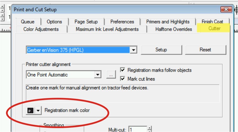

Sorry all forgot to say signlab, just been into print cut setup and cannot see where I select the option for spot registration.

IT's located on the cut tab in print cut setup. See attached image

If you don't have the thermal modual, rather than updating Signab I would look into Omega 3.0 or above!
