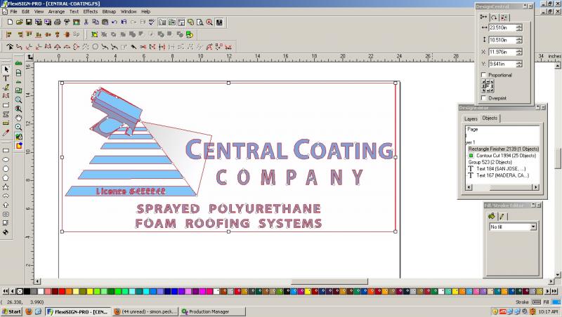

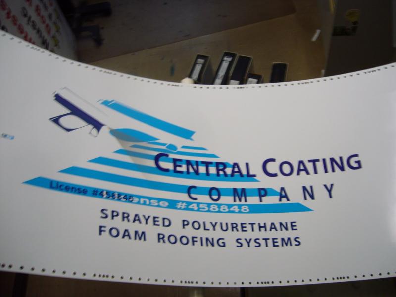

I've just had a problem with my Edge2 for the first time ever. :(
I bought some UV Guard that Jeff recommended and used the "finisher" effect for it on top of "contour cut". I don't know if the extra step is causing the problem but thought it worth mentioning.
One of my colors is printing out stretched and out of place, and the UV Guard is printing way past the design dimensions.
Please see pictures.

Nevermind all, I got it working fine now. There were a couple of Gerber spot colors that weren't supported by my Edge2. Once I switched those around it fixed my problem. ^_^
