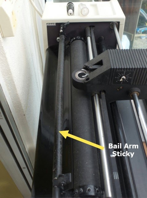

I've not used my GS-15Plus plotter for over a year!!!
Today I decided to give it a thorough clean before cutting some labels. I found the bail arm was really sticky - I mean, very sticky! I tried cleaning it but this didn't work.
attachment.php
I recall this had been a problem in the passed.
Anyone have a solution for this - maybe wind some vinyl around it?

Try cleaning it with alcohol. If that doesn't help then it's turning gummy and you may need to replace it. I've seen this happen with the rubber deteriorating when it starts getting very old.
James Burke
Per good advice from the plotter doctor:
Remove the bail roller from the plotter and carefully cut off the sticky rubber and clean the steel rod thoroughly. Go to the auto parts store and find some rubber fuel line hose with the inside diameter the same size as the bail roller rod. The inside diameter may be a touch smaller, and you will have to push it on from one end and keep steady pressure at that same end in order to keep the hose moving. Try not to get any twist in the hose.

I'm guessing I'll need to replace as cleaning just doesn't appear to solve the problem. I was really surprised how sticky the roller was - it's as if it's melting in heat!! Strange.
James, it sound like you've encountered and solved the problem I'm having?
Parts seem only available from the US - Advantage for one. I've been in contact with them about sending to the UK but I don't believe they're interested!
In the short term, I might try placing a layer of thin vinyl around it.

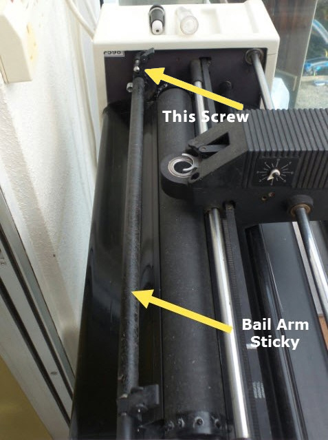

Just a quick question before I get to it, are there any hurdles to overcome in getting the bail arm off? I think it just floats on it metal rod shaft. Is it a case of just sliding it fully to one end and then applying a little outward pressure at the other to disengage it?
Cheers
John
Fred Weiss
Merchant Member
Cheers
John
No. You would likely break the bail that holds the roller and holds the punched vinyl on the sprocket pins as well. You will need to get a hex wrench that fits the stainless steel shoulder screw that holds the bail on either end and unscrew one or the other bails to remove it. This will allow the bail roller to then be removed as well. When you've completed the repair, reassemble by reversing the procedure. You should also get some thread locking fluid and apply it to the hex shoulder bolt threads before screwing it into the threaded hole in the aluminum side so it doesn't work its way out in the future.
