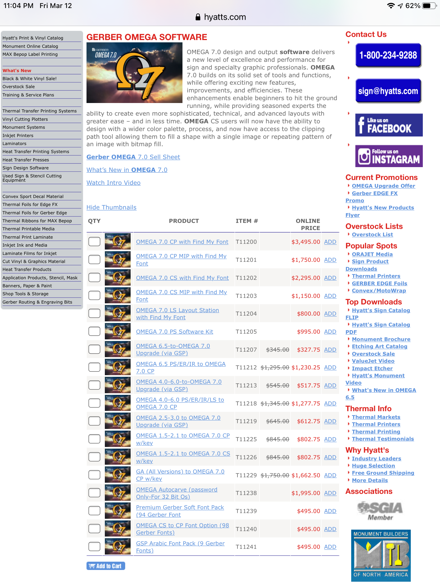

I spent the $345. And upgraded from 6.5 to 7 and must say I like some of the new features
Hot folder - save templates- user selected vinyl, spot and process foils in vinyl select area for easy access - improved back cut and a few more
Easy upgrade using usb - no issues and everything migrated to new Program including jobs , settings and plotter / FX settings - after updating I was up and running jobs with no issues
main reason I upgraded was my program was getting buggy and I didn’t want to reinstall and have to redo all the updates, the $345 update was cheaper (in my opinion ) than the time I would have spent reinstalling and updating so now it’s time to watch YouTube videos of new features while jobs are printing ...... updating from older versions can be pricey, many vendors are running specials so if you’re thinking of biting the bullet check around
So all in all I’m glad I did it and I’ll let you know if I run into any bugs or horror stories .
-Day two and still no issues -

Hello Jeff,
My source for this is Tubelite. Who did you get it from, if you don't mind my asking. Tubelite has been a challenge to work with for the past 8 months or so!.
Thanks... Bob P

Hyatt’s promo through gerber - delivered in 2 days
