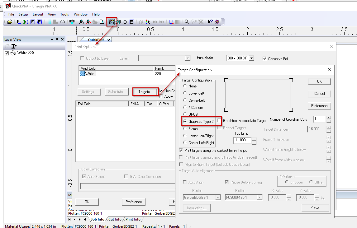

Joe, you just made my day by saying graphtech will cut Edge Graphics. Thank You! My Gerber GS 15plus quit working suddenly last week (electrical issue of some sort). Which is why I posted earlier about plotter suggestions. Your statement just sealed the deal & now I’m definitely getting a graphtech. I can buy a 64” graphtech for the same amount it would cost for a 15” Gerber.
Is there anything special I need to know in order to get Graphtech to read Gerber registration marks? I have an Edge 2.
My Graphtech is still on the way but it will be great to have information for when it gets here.

I have printed on Edge and used a graphtec plotter thru flexi. Unless I was missing something... the crop marks take up print width - was only able to print 9.5 inches or so wide.

Yes, since the reg marks sit outside the graphics, you do loose some width. It's been some time since I've done that. To set it up, Click on the Print Options (123 Icon), then click on the Targets button and select Graphtec Type 2:
