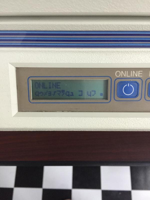

We have a gerber edge that we use flexi to print with and for some reason it just decided to stop working. When we go to print a job and it says to push the button to print it comes up with an error and goes into a bunch of random symbols. Would anyone know what is causing this?

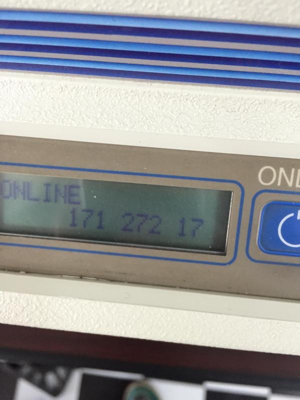

i've had similar #s pop up onscreen. i think i was able to resolve it by reseating the ribbon cable (then eventually replaced ribbon cable).
