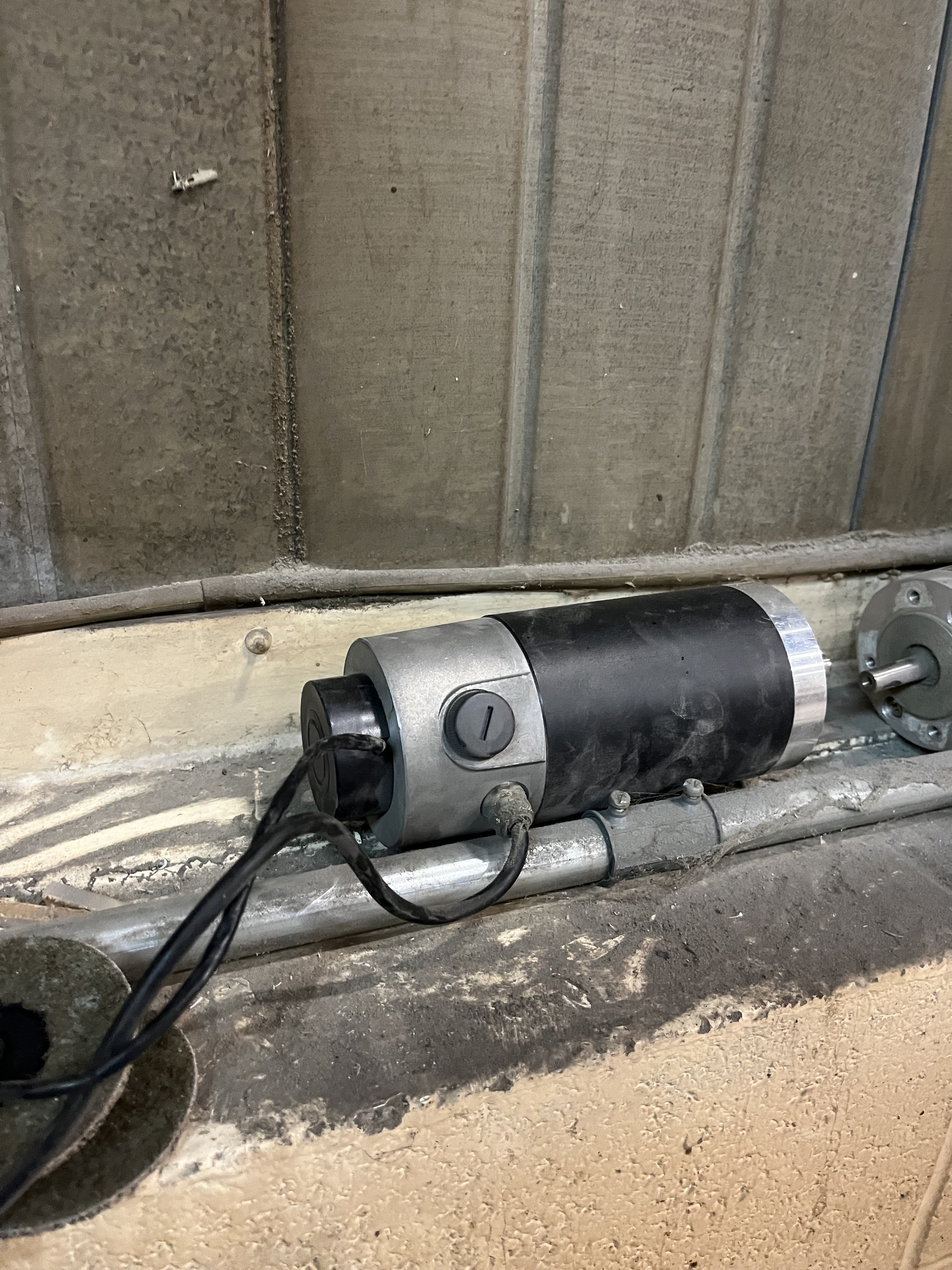

Thank you for your replies much appreciated. Attached is a picture of the motor and encoder on these.

netsol
what happens when you leave motor connected electrically but not bolted in?
turn machine on, does motor turn, "step" or "pulse"?
Squiggy
When the machine is turned on there, used to be just one beep now there’s a series of beeps and it immediately errors out. I don’t believe the motor pulses at all.
