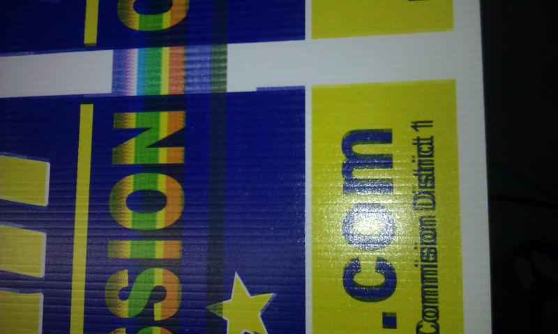

However, now the print is terrible SEE ATTACHED PHOTO. If you look closely, you can see the ghosting and then about a foot into the print the colors go crazy. The white band should not have any color in it, the text should be yellow and the box should be a solid blue.

how are you connected from computer to printer? 'data link error' sounds like you are having throughput problems. and as for the picture: looks like mis-calibrated heads.

Well, it turns out the problem was the flex cable that runs from the gantry board to the carriage board. I replaced it today and it is now running well.
