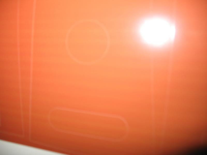

Getting Hella Branding on my SP300 in brown and greens.. What to do?
Just replaced all of the dampers... Still get branding in browns and greens BAD.

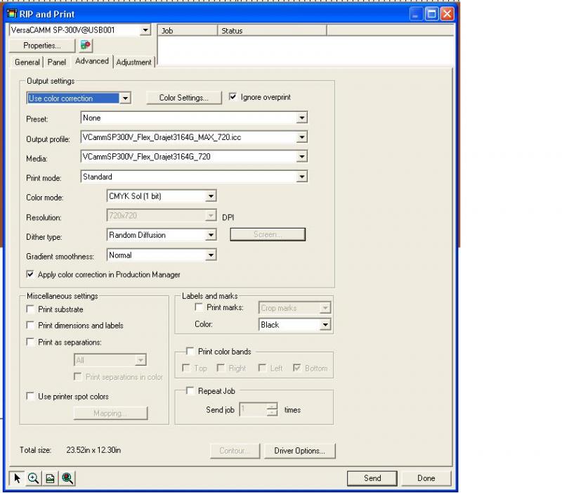

I'm printing mostly on orajet 3164.
Here is the setting for my profile
The temp for the heater and dryer
are 50
Help! :notworthy::notworthy::notworthy:

Try changing the Color Mode to 2 bit, not sure if it will solve, but I have always setup flexi with 2 bit color mode on all new installs.
My .02
