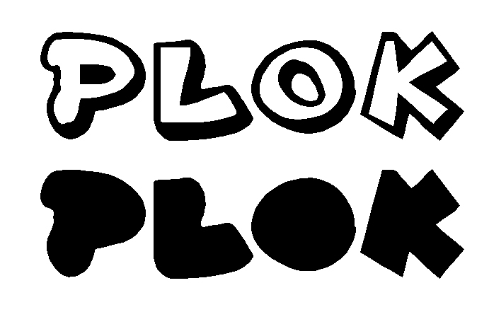

I am using the Font Plok. i am making the letters Black, and i want to have a white background. I could cut the whole thing again and not weed out the inside of te letters but then i will havea cut where it meets the black and will eventually shrink come and reveal the surface. How do i cut basically just an outline of the letters but the exact size of the black that i have already cut? did i explain clear enough?

okay the black in the picture is going to be black. but i need a white underlay that is the same sizr as the very outside of the letters.

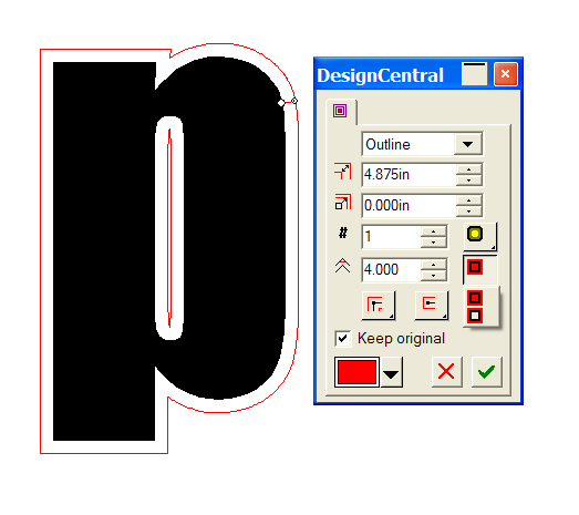

Have you tried messing with the outline functions?

if i use the outlin i cant make it the exact same size. i want to just alter the text i already have because i am using registration marks to line everything up at the top. i dont mind laying the white over black but i will have the same problem. it will have the cutts where the middle of the letters were supposed to be weeded out. basically i need to make another set but without the center cuts. just a contour of the outside line the exact same size.
