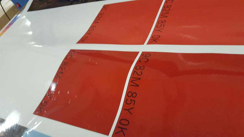

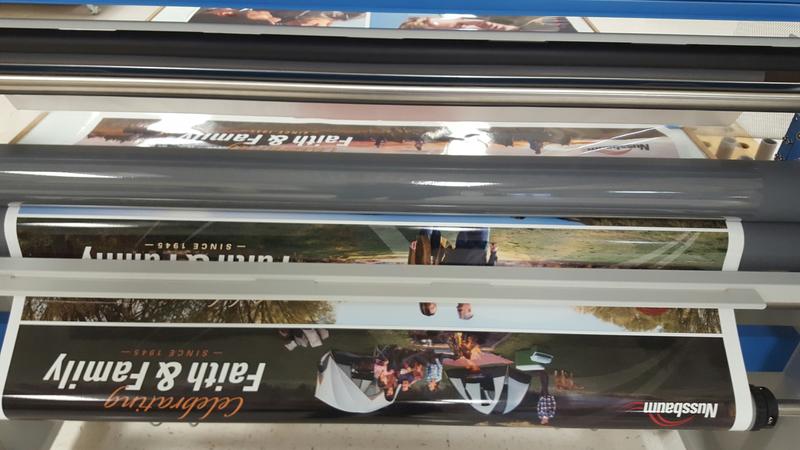

we recently purchased a GFP 563TH and our business is fleet graphics, 53' trailers. I personally think this laminator is the wrong choice for vehicle wraps. I would love a Seal 600MD but those are discontinued. I have attached some pics to show you guys my issues. Cannot figure it out!

Your roller tension looks too high due to the waves in the print. Also is your laminate centered on the rolls?
You also need to balance the tension on the feed roller too those little bubbles on one side of the machine is due to laminate buckling as its going through the rollers.

if i stop it when it starts to feel a little snug then it doesnt seal the laminate to the vinyl properly. After laminating i can take a squeegee to it and it seals it down properly. And thicker mil laminate like lustre laminate won't seal down at all.
