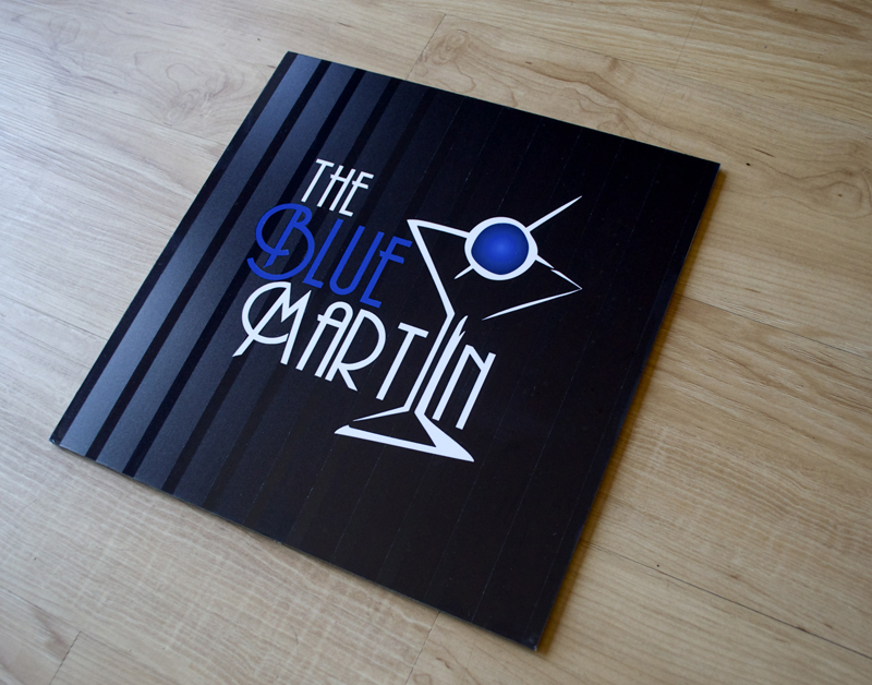

One of our customers asked for a sign with ghost stripes on it. Anyone familiar with those? We have never done them before and while we may have the equipment/capabilities, we aren't sure how to go about it. Any advice would be appreciated!
CS-SignSupply
Are you referring to a solid background with semi-transparent stripes over the solid color? Sorry if I do not understand.
mikes1975
Cibersupply- yes, I think that is exactly what the customer is looking for.
Jhilldesigns- Thanks! We'll give that a try.
ucmj22

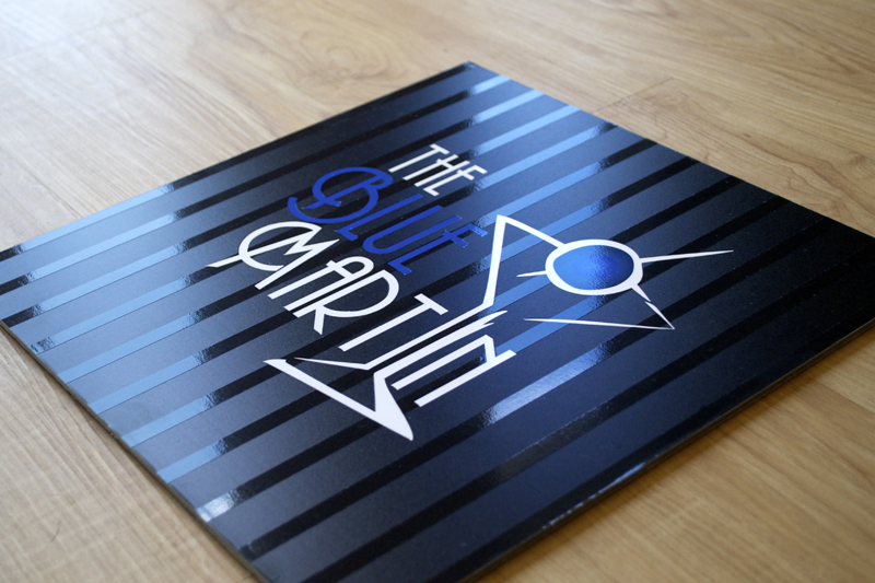

I did this one. printed on matte, then contour cut gloss overlam and applied.
