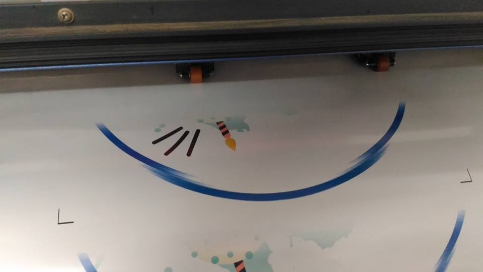

Been trying to solve this by myself by cleaning the head, cleaning the encoder strip. unplugging it. But could not find a strong solution. Is it caused by static? please help Roland VS640 is my machine.
https://imgur.com/a/9yu4jf0

Try cleaning your feed encoder disk. It's a clear plastic disk on the right end of your printer that's attached to the grit shaft. It does the same thing for the feed direction that your encoder strip does for the scan direction.
Good Luck
Good Luck
THANK YOU THANK YOU!!! I didnt even think about the feed encoder disk!!!!! Thank you so much.
