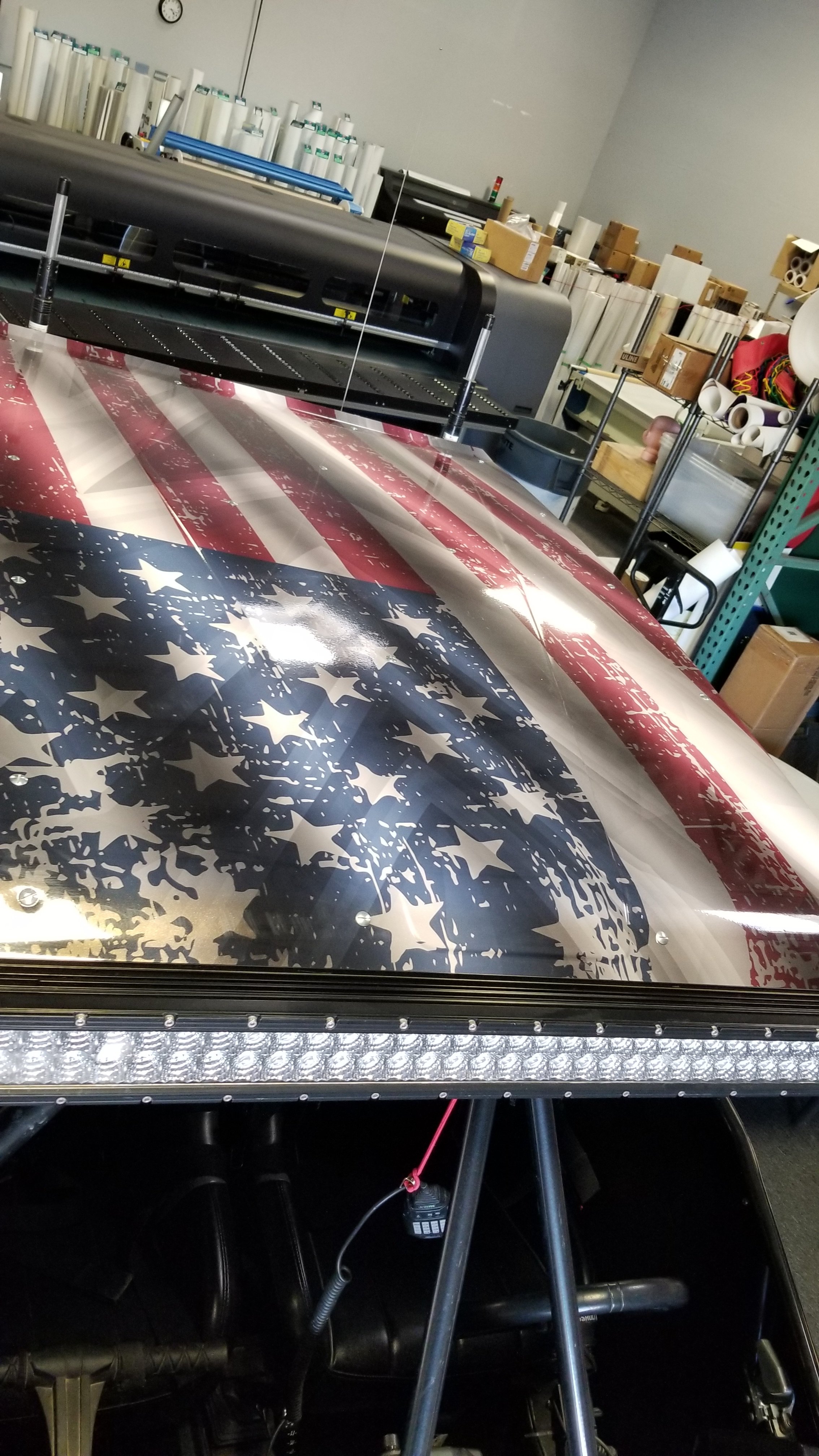

Does anyone know if there is a digital printable pressure sensitive glitter vinyl? I have a Roland Verscamm and use Ecosolvent Inks.
We print on Avery Diamond white or in this case 3M Gold Flake White, but we have a latex.

I've printed on Avery ultra metallic with eco-solvent. Many times. Works great. There isn't much, if any, vinyl you can't print on with any sort of solvent.
jwilde
In the past, I have just laminated whatever material I want to print on with a clear printable vinyl. You could do the process before or after printing. Print to clear and mount or mount then print.
