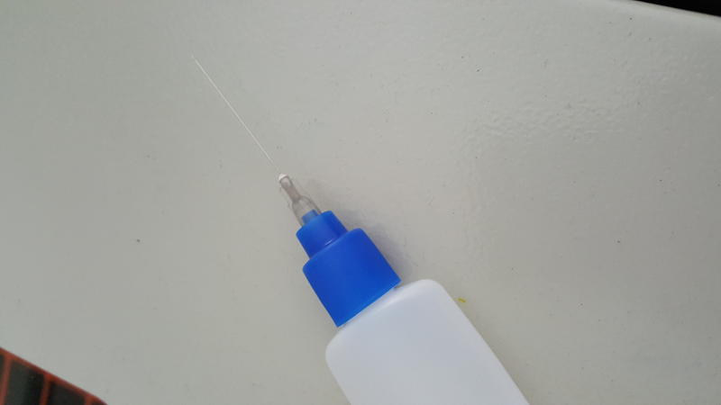

We use weld on #4 fast set for with a needle applicator

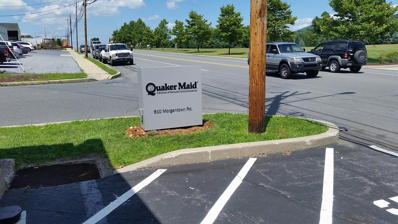

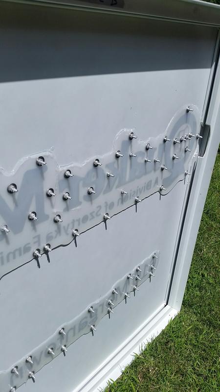

This is the proper way to have acrylic light up on a opaque background. This is router and push through lettering , there is also router and backed up lettering. I dont think you will ever get it perfect that you cannot see a glue discoloration the way you are doing it. Do some testing and check, next time do it the way i showed you

FS-Keith, can I ask how thoes metal pins (not sure what you call them) attach to the dibond? Thanks.
they are stud welded onto the .125 alum face that is glued to the retainer system. we typically glue the faces on the front of the retainer for a cleaner look when we are building the cabinet.
