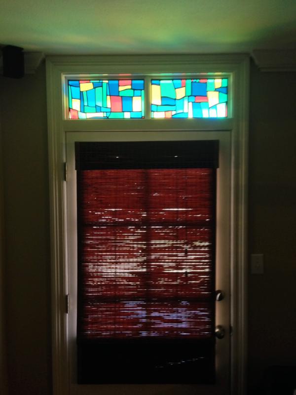

BTW I did something very similar to this by printing on lam then re-laminating to create some "faux" stained glass at my home. Overlayed with matte black vinyl to make it look more realistic. Only I doubled the ink, and also printed a mirrored version, so it is applied to both sides of the glass... just to make the colors more vibrant.
