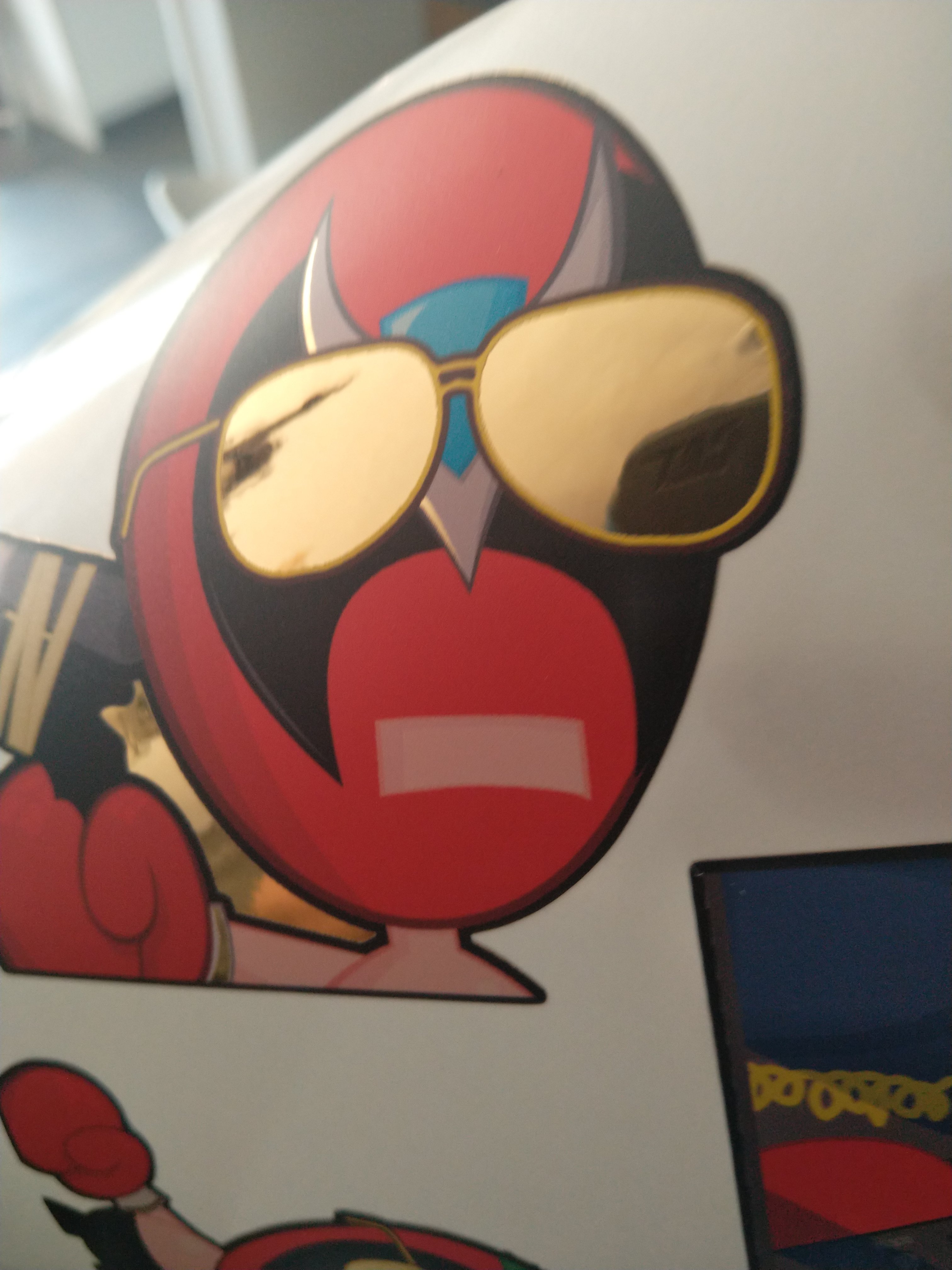

Dangeresque has gold sunglasses, so was a fun print. Got the gold as a small sample roll, so wanted to see how well it worked. Color on white print on the UCJV300, but would probably work well on solvent too.

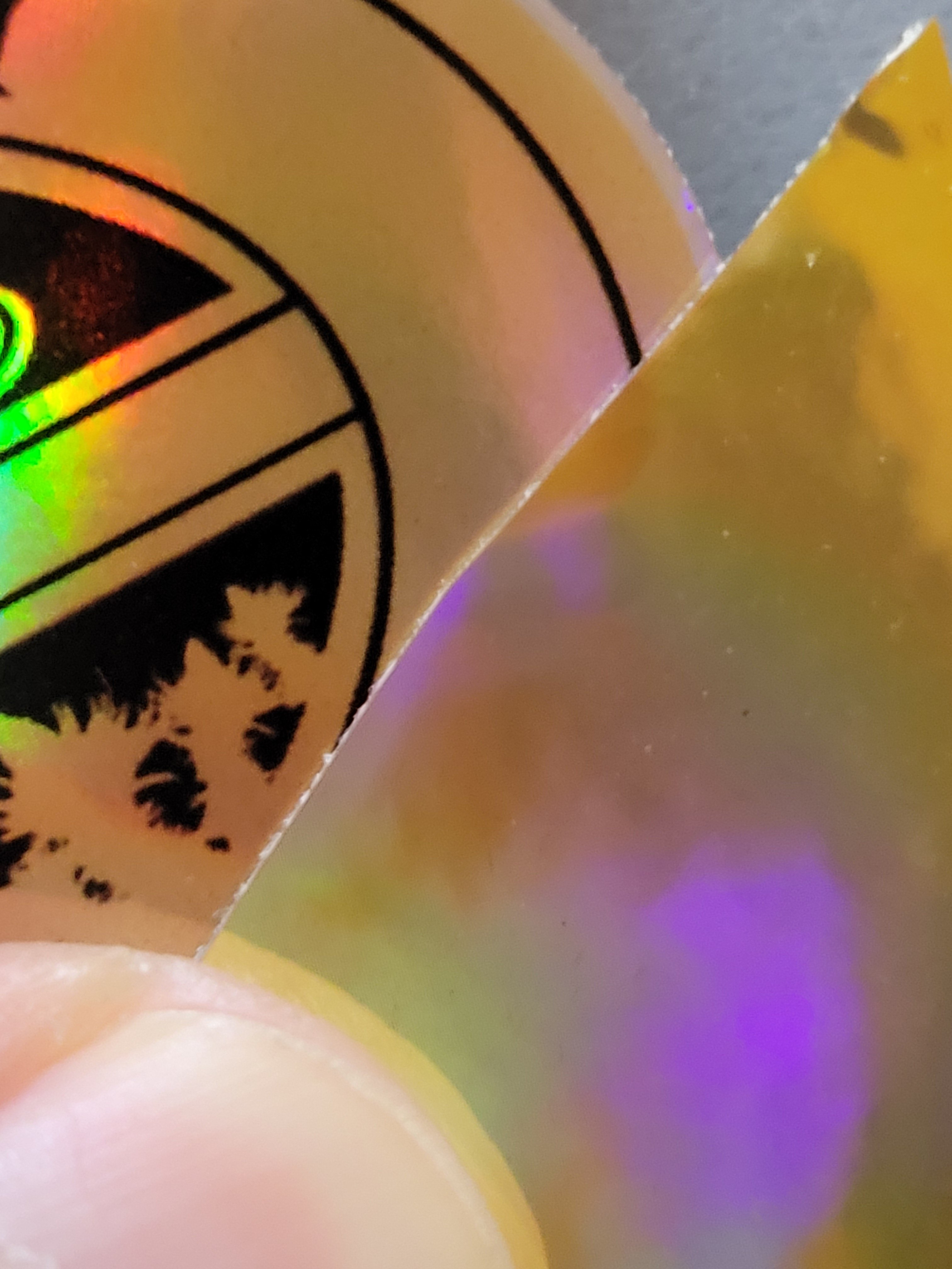

So I went and came up with a color to come close to the gold vinyl I printed on before. Doesn't look exactly the same, but I told them it wouldn't be an exact match to the previous run from a couple years ago. I used some sign vinyl that has been out of stock for at least a month now.
Right is the sign gold sign vinyl and left is the printed sticker.
