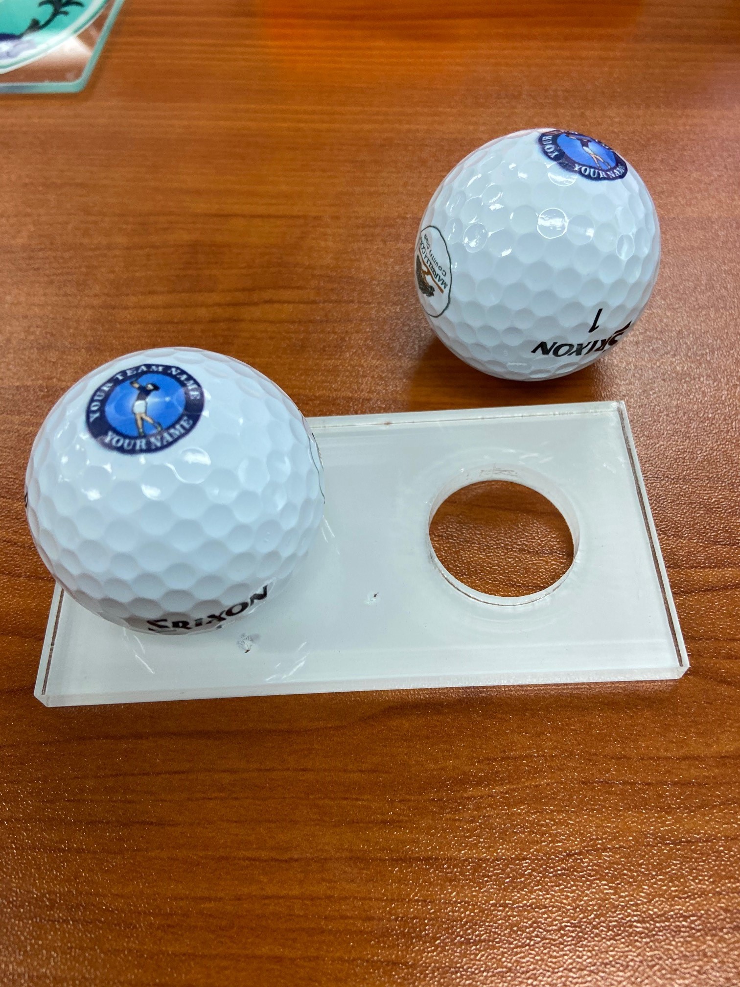

Excellent adhesion on Srixon balls

Lus120 with PR200 primer. This is a flexibel ink. However the most important thing in order to get good adhesion on prints on the Mimaki 6042 is the interaction between clear coating on the golf ball and primer. We only found 2 factories that uses clear coating that reacts well on the Mimaki primer. Most of the other factories use clear coating that doesn't react well, which means ink breaking on impact.
