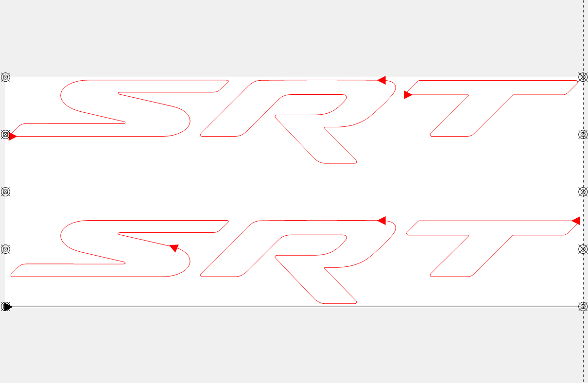

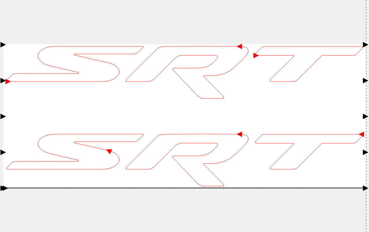

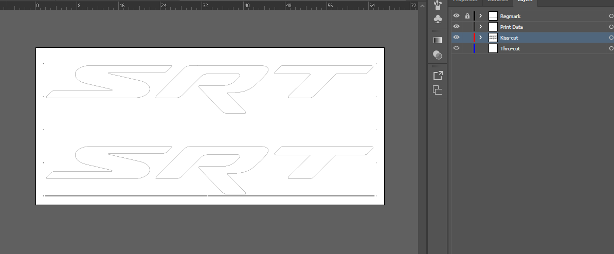

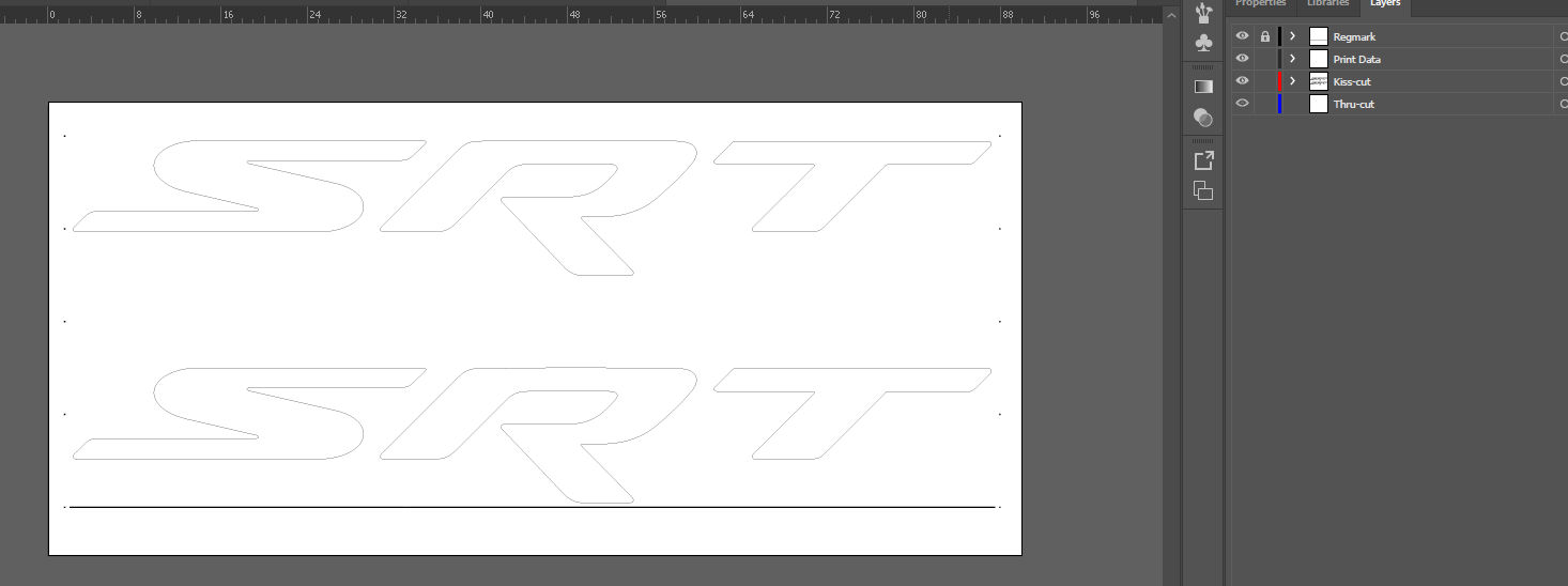

Hi! Yes they are on a different layer. The file is completely set up how it should be its just that when I go over 63" inches or so (landscape or portrait) the program doesn't create "bullseyes" as it should. Once I go over 65" its tries to actually cut the reg marks. Screenshots below.
The first two screenshots are Illustrator and GoSign. The cut size is 80 something inches... The second two screenshots are when I make the cut size under 65 inches. I really think it may just be a limitation of the software that needs to be changed on their end.. But not completely sure.

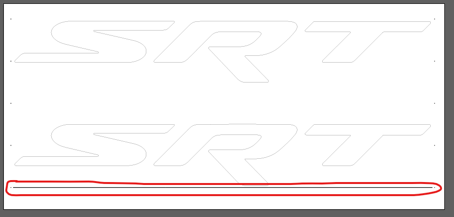

Not a problem. The issue you were running into is because the bottom of the image in Illustrator is where the plug in puts the leading edge of the registration marks, the black line circled in the attached photo. It doesn't matter if you rotate the entire image + registration marks later because that black line will still be in the same orientation and GoSign will always see that as the leading edge of the print.
