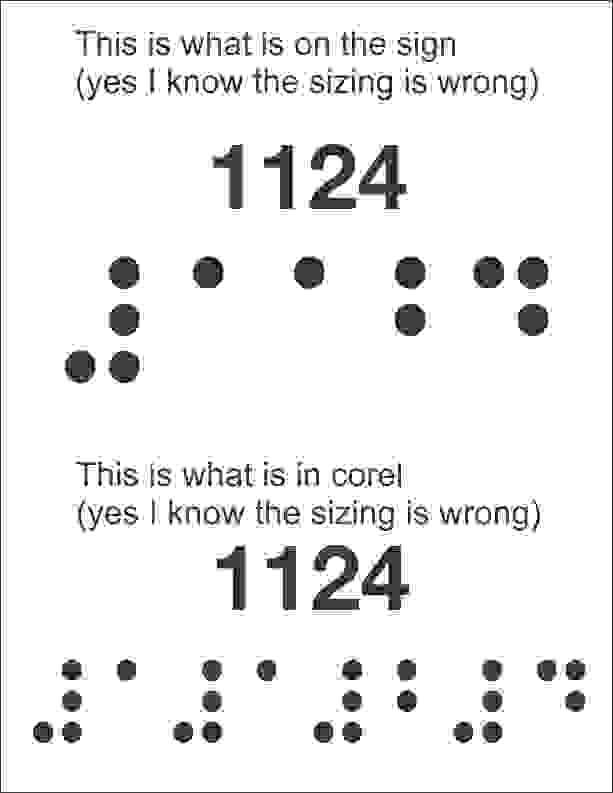

Where can this font be gotten?
I have "braille" in CorelDRAW x5 but when I type in the wording, specifically numbers, it does not match the braille beads that are on the physical sign when it arrives. Usually it is loaded with the "number symbol" on my design but is not on the sign.
I would like to be able to
1. design the sign up to show the customer what it looks likes and location of the braille.
2. verify that what I am getting is correct.
Rick

I have been looking at the Duxbury Systems, was hoping for a faster method that was already in CorelDRAW.
here is an image of what I am referring to

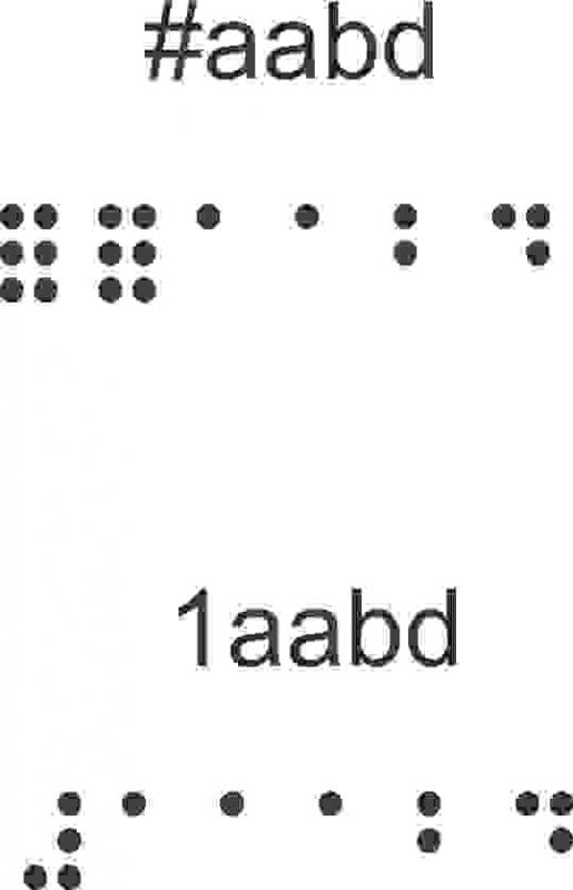

There was a Grade 2 font, the one I had was for a Mac, but I never got to work right
In that Corel font, you might type: (note lower case)
#aabd

The correct is 1abd... you have a freaky braille font.

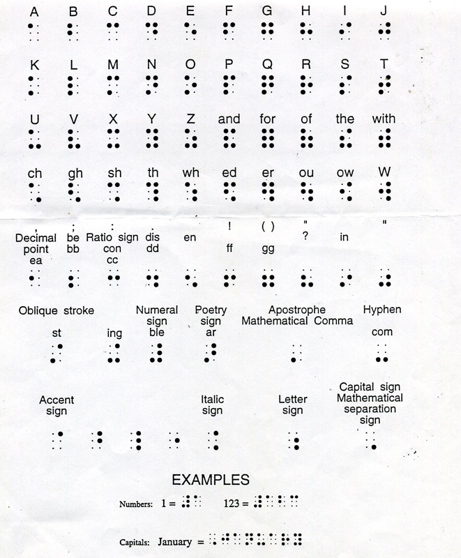

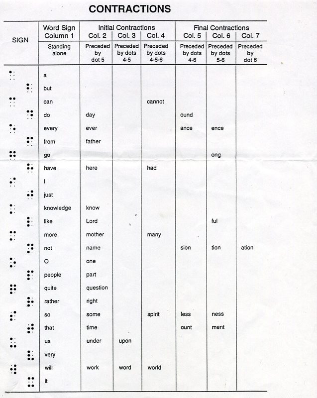

I can't scan my big arsed book of braille, but I can show you these 2 pages from some seminar I went to. It has enough to get you by on Grade 2 braille.
The only reason I can read grade 2 Braille is it was "drilled" (that is a raster braille joke by the way) into my head when I was translating for ADA signs, and I sometimes help other sign shops inspect their ADA signs prior to install to make sure they are compliant. Shocking how many ADA sign shops screw up their braille.
