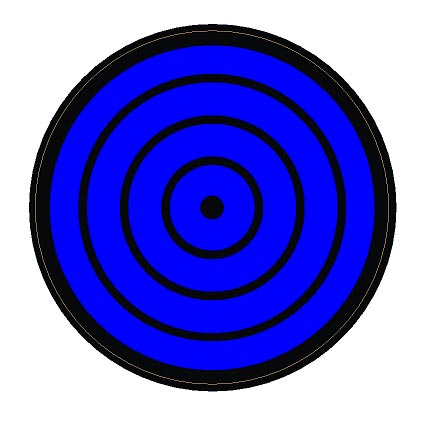

Hi all, I've just updated my flexi to version sp5p3.
After the update, I couldn't get the right color of the gradient from illustrator. It will turn to solid blue.
I've tried to save the file to different version of illustrator and also to PDF.
I've used this file/gradient for a few project and no problem before I updated the flexi.
I believe must be the new setting/preferences since update will reset the previous setting?
Thank you very much in advance.

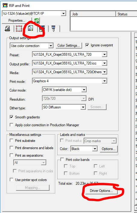

In your rip settings is "Use Color Correction" in the drop down box checked? This is required if you want the artwork from another draw program to be as shown from that program in Flexi. I have noticed that during some updates it defaults to "No Color Correction".

In color setting, there is no color correction....only display setting and input profile.

This is also one of the mistery, the production manager display the color correctly but not the editor. Only with this version though, the privous one both showing just fine.
