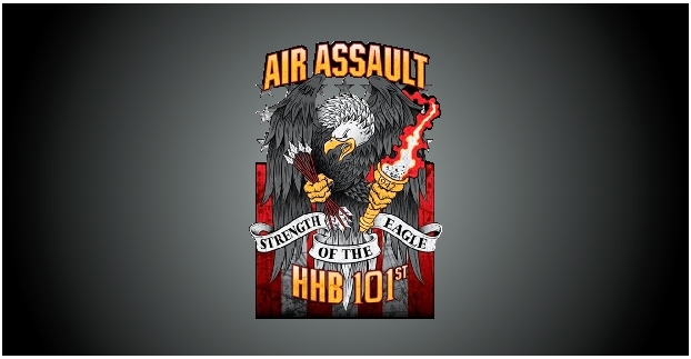

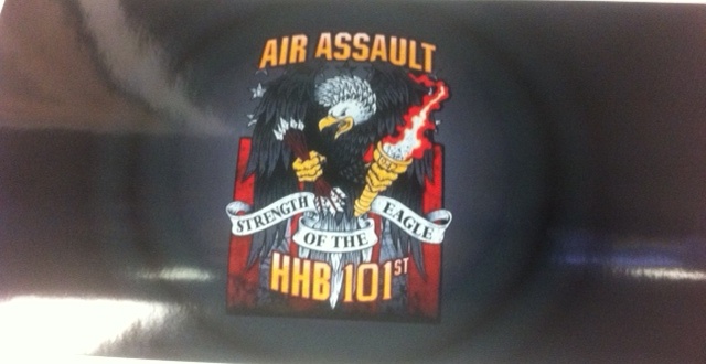

I'm trying to print a grey to black radial gradient on a roland versacamm sp540i and it's coming out strange. There are alternating light and dark rings showing up. I've tried changing profiles (using versaworks), rendering intents, 16 bit gradients dithered to 8 bit, and I'm not sure what else to try at this point.
The first pic is what's coming out of the printer and the second is the art.
Any ideas what to do?

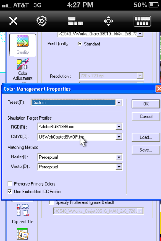

JoshLoring
Your problem is that your versaworks profiling is wrong. Sign and display? PrePress? What do these have to do with Adobe files? Nothing..
You should be setting your icc to adobe 1998 and matching your adobe suite color settings to that. Then, versaworks can understand your file..
JoshLoring
I'm not at my computer- but I screenshot via VNC and this is what you should have set it versaworks..

SignStudent
You've got me confused now. I'm not sure if I understand what the box that says "use embedded ICC profile" does. Is it referring to the adobe1998, us web coated swop, sRGB, etc. settings or to media profiles? The way I thought it worked, which may certainly be wrong, is that because you're using the embedded ICC profile then the rest of the settings you have screen-shot will be ignored.
This would mean your Adobe and VersaWorks settings don't have to match because it's not using both of them. If you tell it to use the embedded profile it uses Adobe's settings; if you tell it not to it will use VersaWorks' settings.
Also, I see you're using Perceptual for both vector and raster. I've always seen it recommended to use Relative Colorimetric for vector. I'm curious why you have it set that way.
I'm not sure why you say Sign & Display and PrePress have nothing to do with Adobe files. They're just different ICC profiles which affect the color space from what I understand. Sign & Display has a larger gamut.

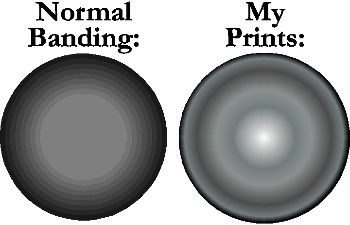

SignStudent
If you open your graphic in PS, and you squeeze your levels together, can you see the banding exaggerated? Or is the screen version 100% fine and you only see it in your print? If only in your print, it's a profile/intent issue. If you see it on your screen as well when exaggerating your levels/contrast, you will need to address that first.
Nah even if I squeeze the levels I don't get the same kind of banding. I made an exaggerated pic so you can see what I'm talking about. The dithering/white noise would fix the pic on the left but not the one on the right, which is my problem. And yeah the more I mess with it I can tell it's gotta be a profile/intent issue like you say.

JoshLoring
-Your settings will not be ignored.. Only translated correctly. If you input an adobe 1998rgb or cmyk and target sign and display- your defeating your input profile. You must input and adobe 1998rgb and output the same to keep the same profile.
-Perceptual is better for both when inputting and outputting the correct profiles.
-You are answering your own question. They ARE different ICC profiles. Why would you design in one ICC and output in a different ICC? If you design in adobe1998 or CMYK.. Why would you output in Sign and display? You have completely changed the color gamut that you designed in.. If you want "what you see is what you get" then you need to input and output the same color profile.. PLUS the right ink media profile.
