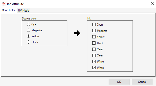

If I create a gradient in Illustrator using yellow as the color, then in Rasterlink change the job attribute to "mono color" then tell it to replace yellow with white/white, it seems to work. (Converts the file to white, and has successfully printed a white gradient) Last test will be outputting my cmyk objects as their own file then create a composition w/ cmyk & white elements and see if they'll overprint. I still find it frustrating that you need to go through all these steps and have multiple files for one print. Both onyx (Spot1) and versaworks (RDG_WHITE) have made it so easy to print white, I guess I got spoiled.

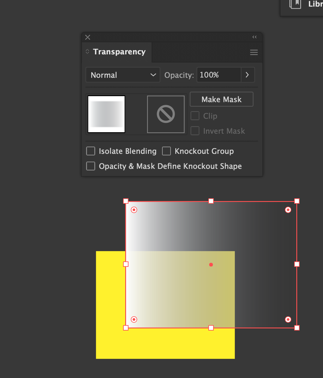

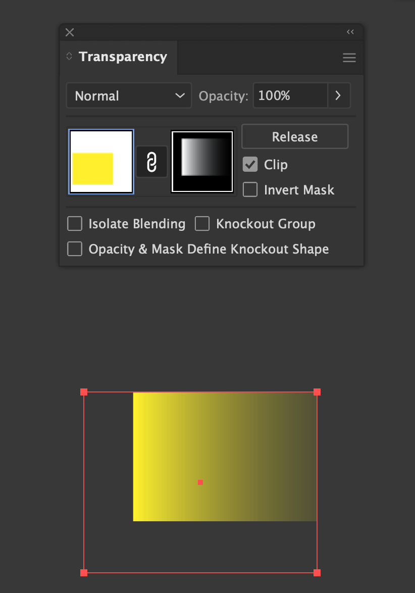

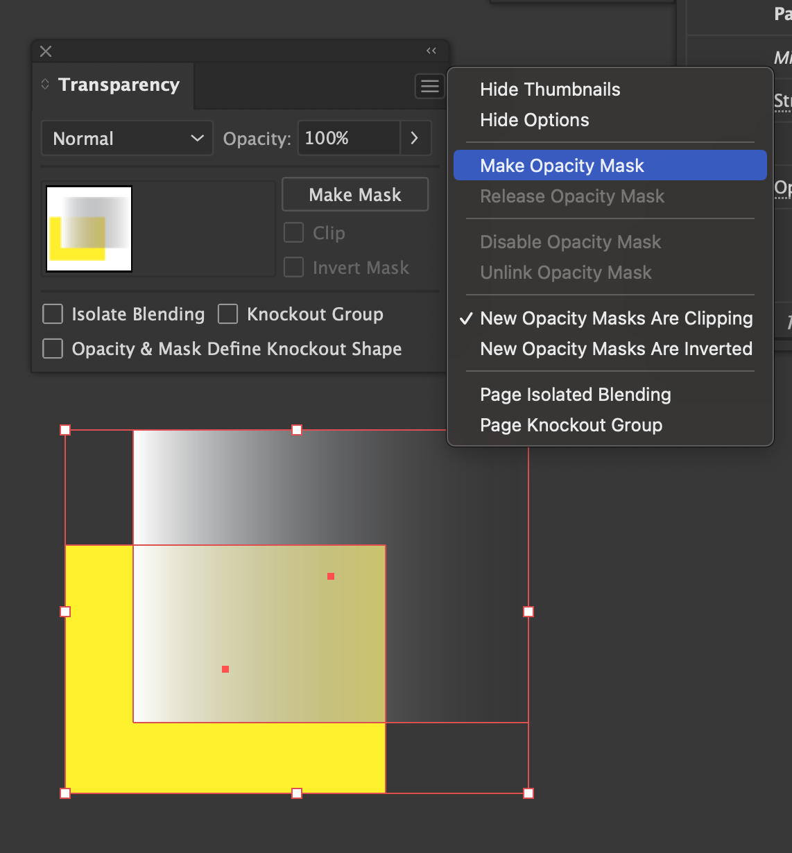

This is how I achieve white gradients out of rasterlink 6. After a LOT of frustration...
Illustrator:
Make a rectangle, or shape... make it solid yellow (or whatever).
Make another shape over the top of it.
Apply a gradient to the top shape, with one side being 100% opacity and the other being 0%.
Select both items.
In the transparency docker, hit the top right menu button and 'Make Opacity Mask'.
Play around with the gradient location and amounts to taste.
Then in rasterlink, find the CMYK value (0,0,100,0 Yellow in this case) and apply a W100W100 colour swap to it.
Have fun out there~

It works just as you outlined. Set the gradient to (in our case, Cyan), output it as a separate file. Import into RL, select mono color, and replace cyan with white. Then composite with the CMYK file and print. I've also done it as a raster image. I brought it into Photoshop, set it to grayscale, then used duotone to apply cyan to it. It also printed as expected. I read a lot of much more complicated methods, but for as dumb as RL is on so many things, it does this correctly.

Create a gradient in illustrator using 1 color only, C, M, Y, or K. save that as a seperate file.
Bring it into RL.
Select that file, go to the INFO tab.
Change Job Attributes to "MONO COLOR"
Select your source color and change it to White.
Hit okay and create your layers.
You can do the same thing to create Clear gradients.
