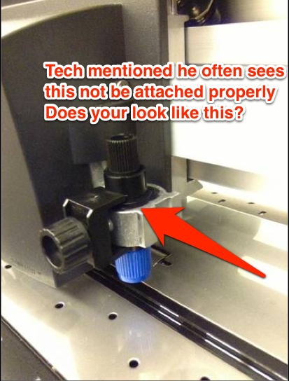

Hi All,
We're working with a graphtec 8000-130, and recently it's been giving us troubles. After setting the cut condition, and running a test cut, everything looks good. As the vinyl advances, and the tool moves away from the origin, the cut gets really shallow. Over the course of a 12" length, we're talking barely scoring the surface.
We've tried a new blade, the grit rollers are clean and in good condition.
Any ideas?
Any ideas?
