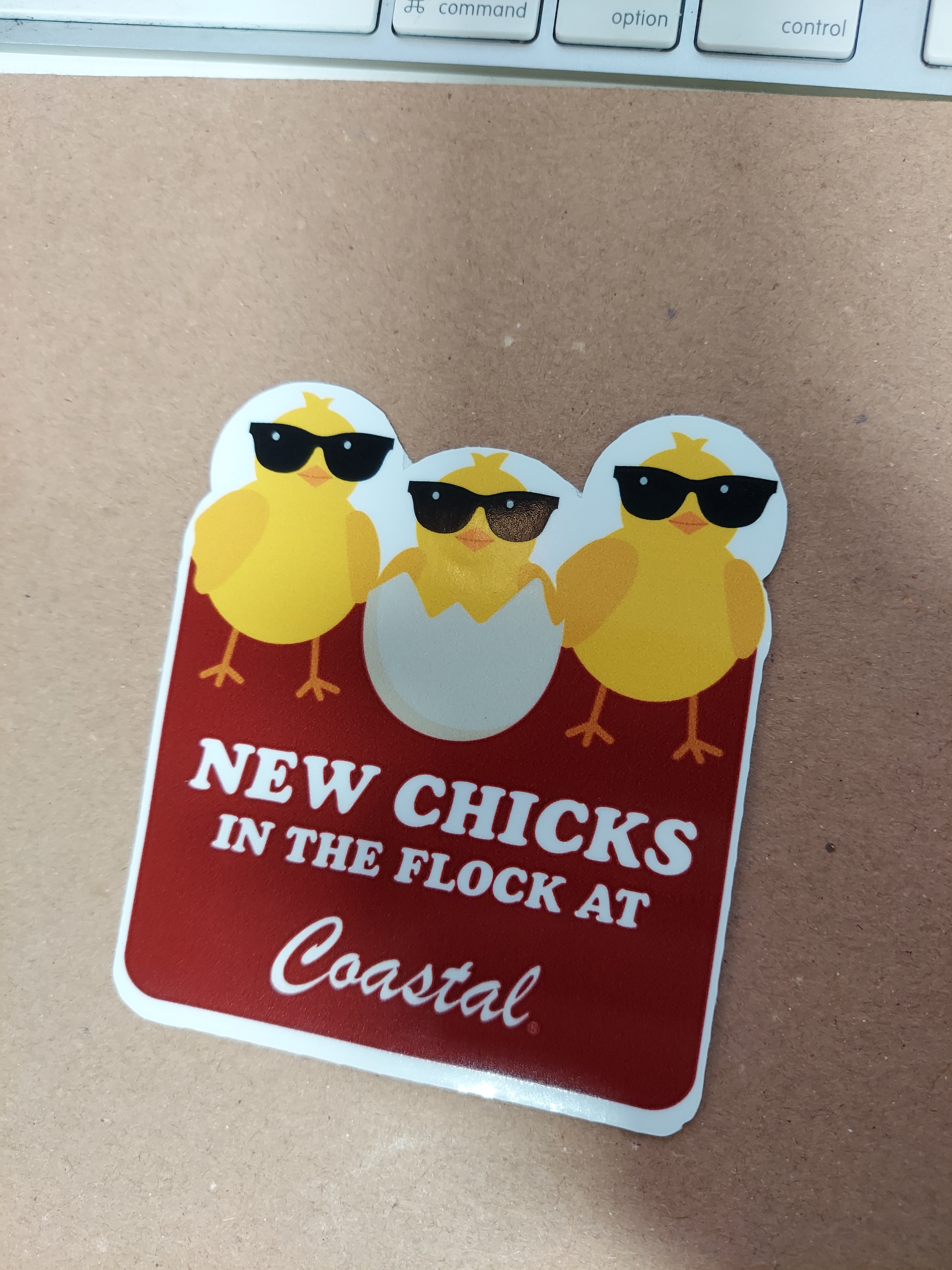

Okay so i have been playing with these settings and cant get a good clean edge and something that punches out easily.. anyone have a good setting for perf cut (half cut) on stickers its a simple design rounded edges and 3 half circles at the top of the box
cut line pattern settings and force and speed for this.
graphtec fc 8600 material is lammed
