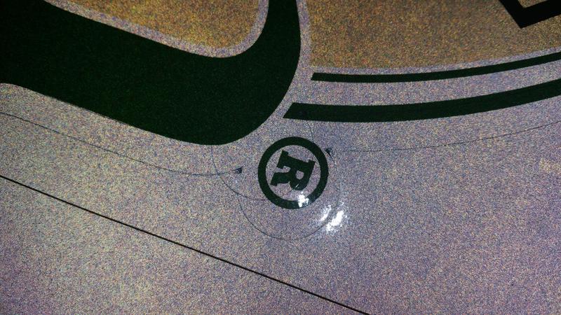

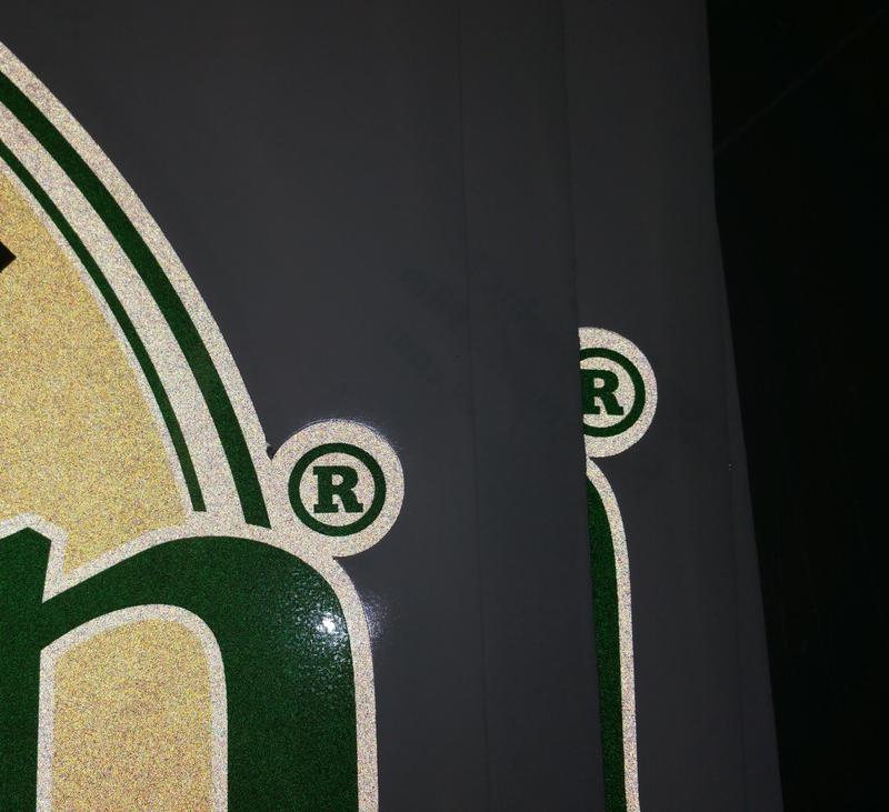

Mine is still pissing me off. It will cut fine for 10 jobs in a row, then be off.
Here's a 'for instance'. I printed 40 of these on IJ5100. 4 at a time (they're pretty large). It cut 9 jobs pretty much perfect. In the 2 in the first picture you can see the top one is perfect, there's one behind it that's off a fraction. Then on the 10th job I CAN'T get it to cut right. Keep in mind these files were ripped once in a group of 4, then the same ripped file was printed 10 times. So, there was only one cut file, sent to the cutter 10 times. Nothing could have possibly changed in setup as they were all literally identical.
On the second picture, the first time it tried to cut is where it cut right through the R. The second cut is shifted to a different place, but still way off.
What the heck??

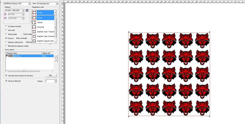

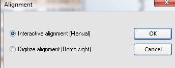

I get asked what type of mark when after i change my plotter to axis alignment. I get this box that pops up. Using this type of reg mark. Is there a way to add more reg marks to the file when the file might be long that way i know i am getting good registration on the whole cut sheet. Like if my file is 3 ft long and i want another reg mark in between the first and last one?
The only option i see when doing manual reg marks is the X with the circle around it that is numbered to tell you what ones to use in what order but no option to add extra reg marks like you can with graphtec segmented.
