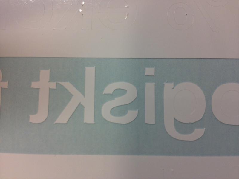

Have set it up, followed all instructions, but it still cuts HORRIBLY bad!
I have posted 2 pics of my problem, that i cant seem to come past.
I cut with original settings, and i use Signtcut pro as software with no altered settings.
Do you need any more info from me, or can someone please help me out?
Any kind of help/tips is MUCH appreciated.

woolly
As above plus the media is probably bunching up .
Could be not enough blade showing and too high pressure
Cutting strip damaged so the media won't slide easily

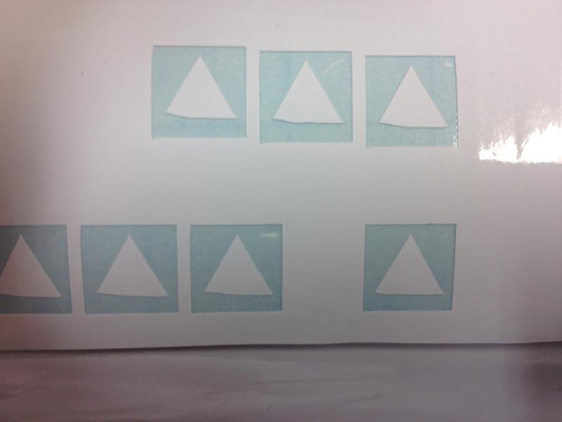

I have tried a new bladholder and new blades, got a bit better, but still not satisfied at all.
the most annoying thing is when i do test cut, the down lower corner of the pyramid is badly cut. the lower line lifts up towards the upper corner
i will try to check if something is loose, like the carriage etc
any other ideas?

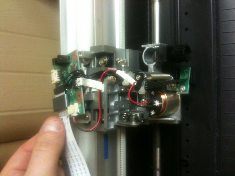

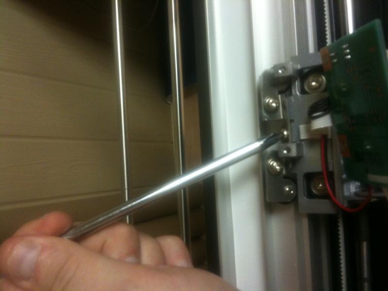

CS-SignSupply
Loose carriage possible.
