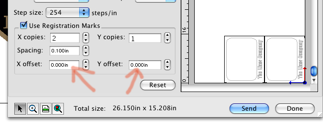

Make sure that you don't have an offset value in the cutting master dialog.
