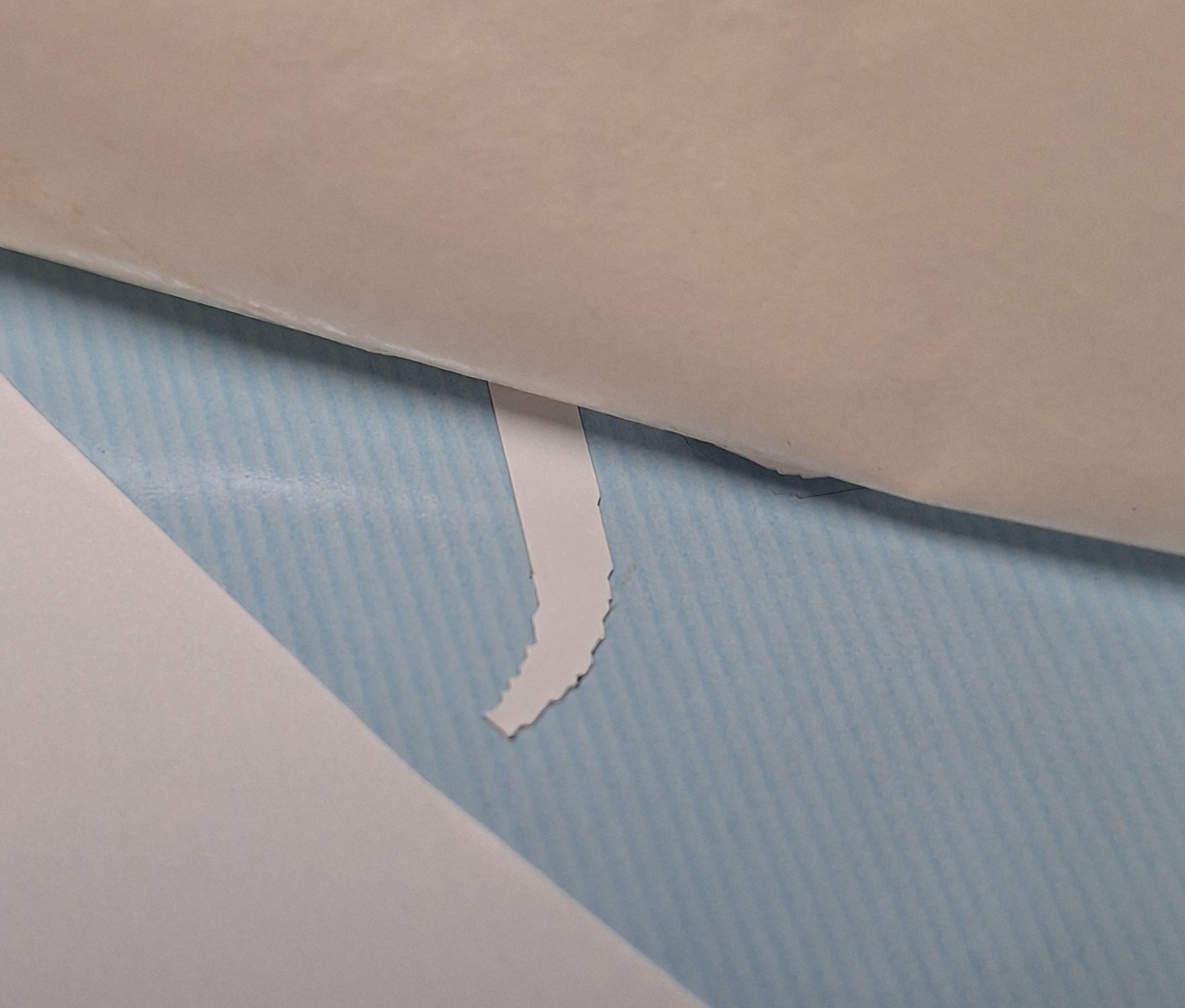

Hello - Newbie here. I have a graphtec plotter and the cut edges of the vinyl are somewhat jagged. Any tips on how to correct this? I am using CM4. The straight lines seem to be fine but curved letters are not smooth.
Thank you as always!

Start with checking to see if your carriage that holds the blade is tight against the rail in which it travels.
