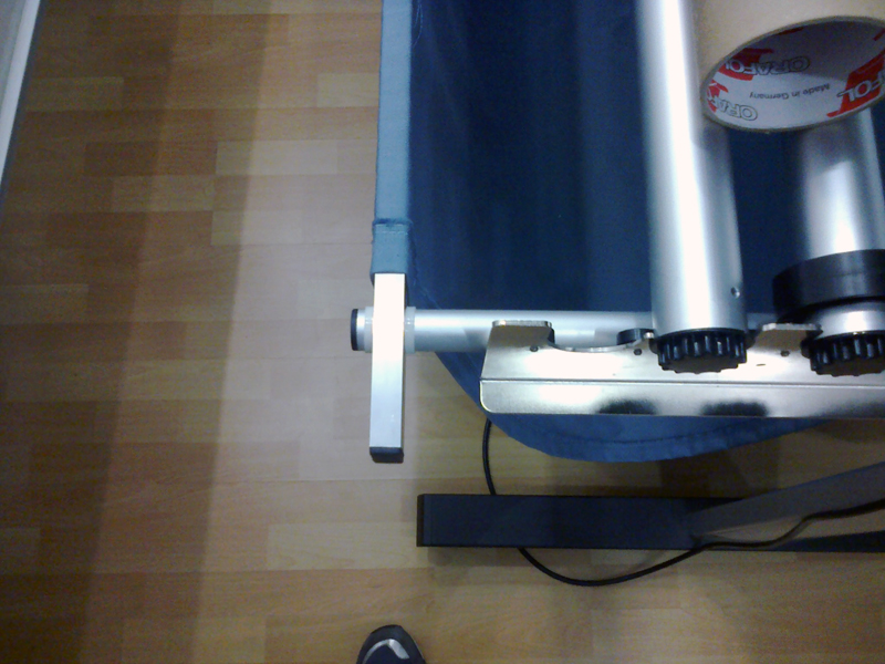

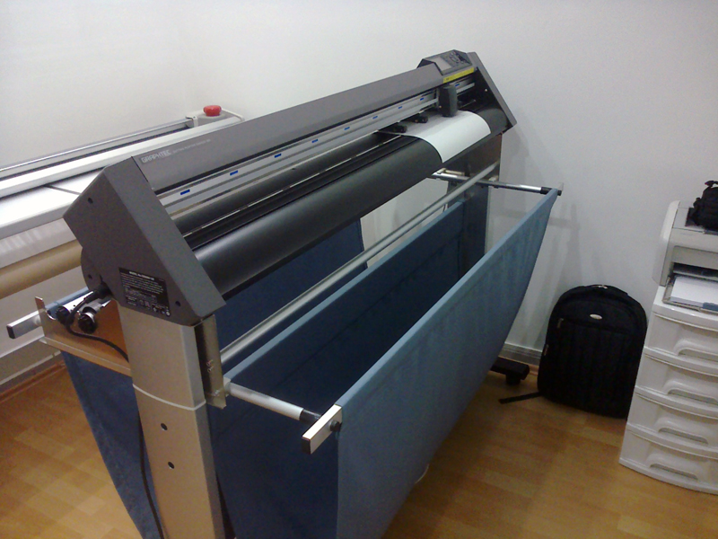

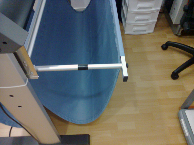

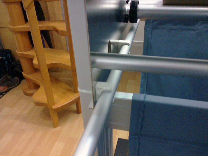

I'm new user of Graphtec CE6000-120 (before that I had a Roland CX-24). Because of the low budget I could not buy a basket for the cutter so I made it myself (by the way it seems that the price for original basket is too high). From the materials I used what I currently have: rectangular aluminum tube (2 pieces), telescope tube from old roll up up (2 pieces), plastic pipe holders (4 pieces), srews, canvas connected velcro tape and plastic caps. The front of the basket can be pull out because I used the telescope tube from the roll up. On the cutter stand I have not drilled any holes, but used already existing. I installed a carrier of the my basket on the inside of the stand, while the original carrier is on the outside of the stand, so my handmade basket can accept vinyl around 133 cm wide, which is enough for me because I use mostly standard vinyl 126 cm wide. I have no sketch, I made basket on the spot. Have only pictures attached, that may help to someone.
