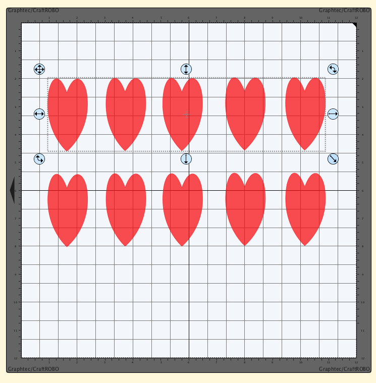

Here is a sample file about 11 inches wide on a 12 x 12 mat. Every time I try to cut everything it shows up on the vinyl HALF the size. I'm guessing it's a setting somewhere but it's driving me nuts. Can anyone help? Thank you.

You didn't specify what software is cutting this....most will have a scale setting. You may have it set on 50%.

Ok, on the COntrol Panel of the plotter, hit MENU, then you should have AREA....click that and check the SCALE there....should be on 1. it can go down to 1/2, which I suspect it is on.
