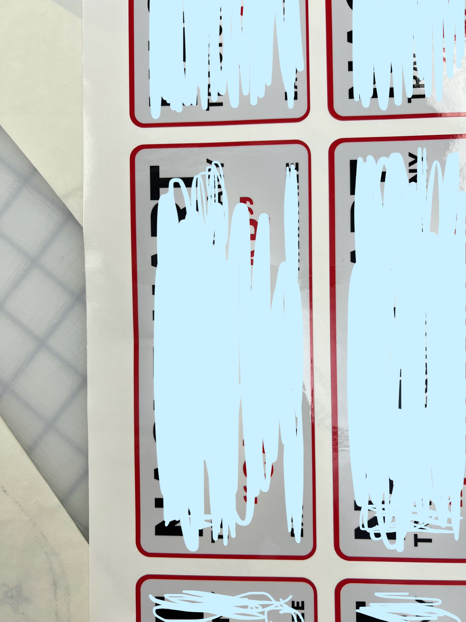

cutter is off. This is with only two rows of decals….
Printed from onyx. I’ve tried different pressures with the pinch rollers but they are still off.. blade was clean and it’s not out too far….

Did you check it with a straight edge to see if it's actually the print that is off?
Or the cut is off completely left to right?
The photo is turned 90 degrees so it would actually be off up from top and bottom.. I have printed theses out A LOT so I don't think they print could be off? I have never heard of it being off from the print....? Would that be a consistent problem? The night I posted this, after I cleaned my blade, I must have hit the tip on the edge because not my cutter isn't cutting at all. I looked at my blade and noticed the very tip is broken. (It wasn't broken when I cut these but maybe it was coming to the end of its life if it chipped off?) I am ordering a new blade and hoping maybe the blade was the issue... (I highly doubt it though.. to me it looks more like an issue with the rollers or how it's reading the registration marks.)

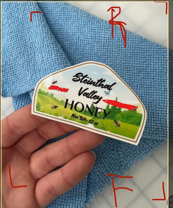

I am unsure if it is off from reading or if it is off because of the pinch rollers. Here is a photo of what I cut out today.... (Drawing marks are to show which way it was facing when it was printed on a sheet.
I have switched to segment auto correction using extra segment marks....it did not make a difference. ugh.jpg
