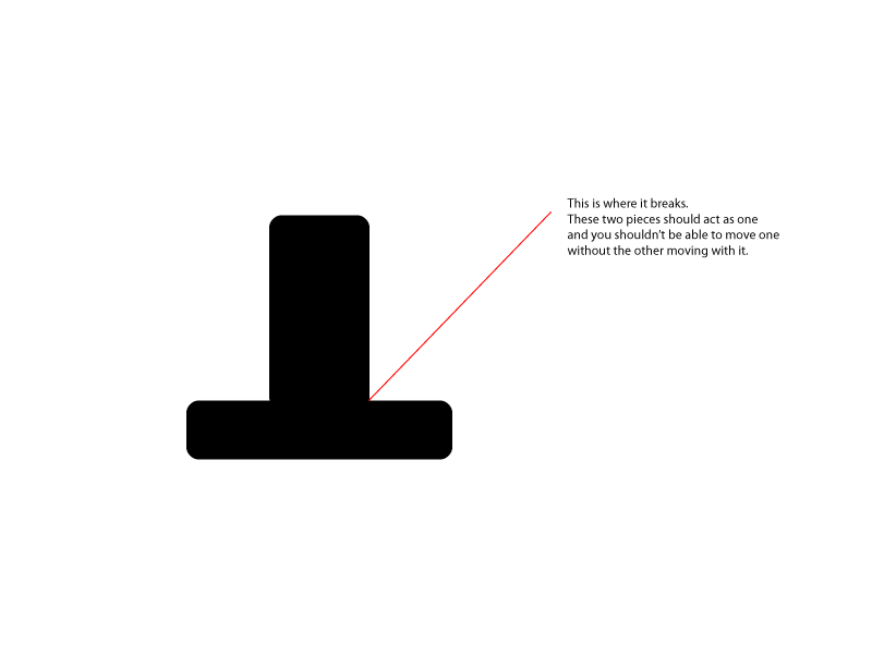

Take the right side cover off which exposes the motor, gears and belt that run the cutter back and forth. There is a gear that has a wider bottom than the top. One part of the gear has a belt that goes to the motor and the other part of the gear moves the belt that moves the cutter tool back and forth. This gear should be one solid piece and not separate. If you can turn the top part of the gear without moving the bottom part of the gear or it looks like it is slipping when the motor goes to move the cutter tool, it's broken and needs to be either replaced or glued back together.
Here is a picture showing what I mean:
