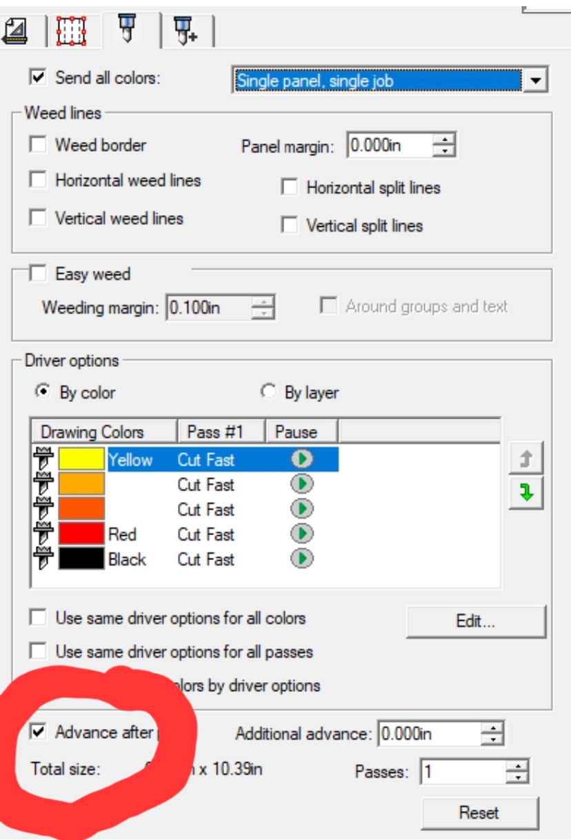

I know this is a simple setting somewhere but I cant find it. Someone changed it on accident. Once the job is finished being cut it pulls the media back to the front instead of being at the end. How do I set it back to stopping at the end of the cut so we can cross cut and not have to feed it out again?
In the cut setup window check the Box, Advance after Plot. Circled in photo.
