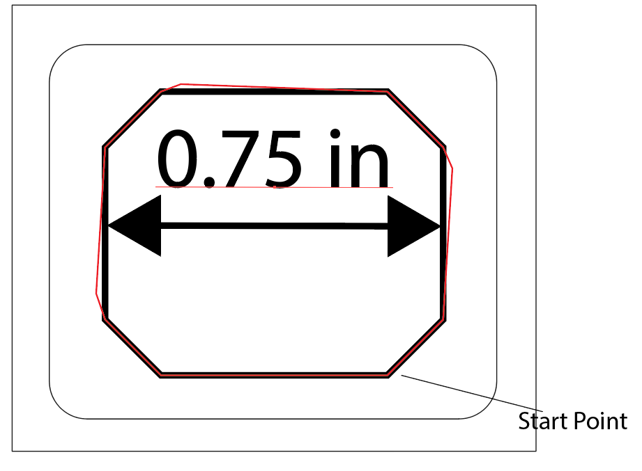

I am very new to printing, just 6 months .. I was cutting die cut stickers on mimaki cjv150-75. everything was good.
I just bought a brand new FC9000. I am new to this cutter. Every thing is good, till i try to cut a decal 0.75" in length. I am not cutting an intricut design, very simple octagon.
Still after weeks with tech support , zero help.
I am attaching the image, should cut on black line, but cuts on red line.
I am cutting. FC9000 is just not cutting sharp edges, seems like its brakes are not working good, where it need to stop and take turn, it lags a bit and then try to come back to track.
Any help will be really appreciable.
regds...garry

What speed is it set to currently. Something smaller like this I'd top out at 20, maybe even 10.

I tried at all speeds 5 10 15 20 25 30
Force 14
Acceleration 1
I even tried with all offsets from -5to +5
I tried tangential mode 1
I tried all all step sizes in GP-GL
I tried different blades too
Nothing helps
If anybody know this more
Regds...garry

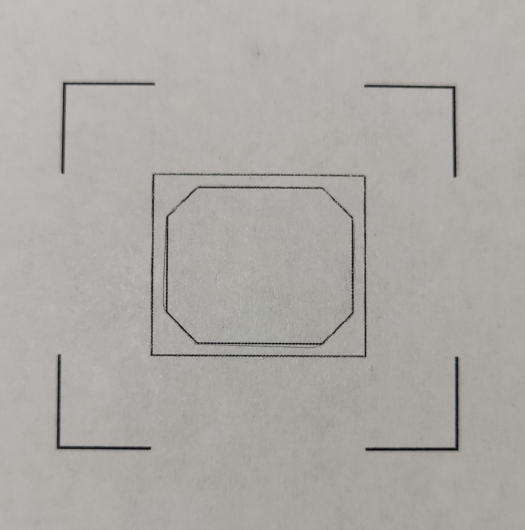

Thanx all again for helping,
As suggested by Ikarasu, i tried on 3" shape too, really not accurate, same problem.
i have checked the grooves on the strip, i saw a little, but its a new printer and i cut this at all different place on strip.
I am able to do all other cut jobs perfectly, just this shape in this size is a issue., if anybody can help
not able to upload video as in mp4
regds..garry

JBurton
Signtologist
Heck, upload the pdf or at least a pdf with that shape.
I guess what printer and rip are you using, and what program is running the plotter?
