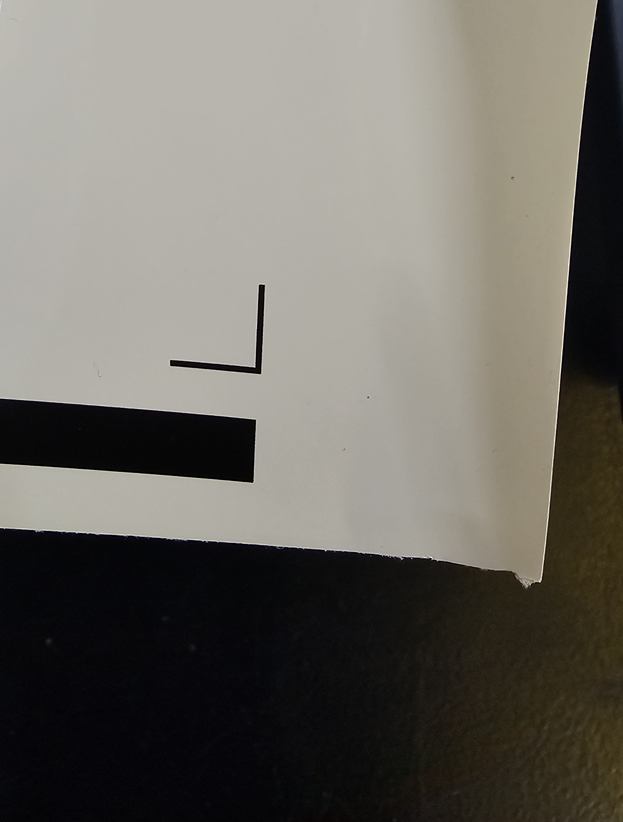

the sheets are 47in x 54in, I've tried segmented area correction too but sometimes the next cut doesn't line up. Here are the crop marks I use.

jharler
I had similar issues and it turns out it was my printer not printing perfectly. Eliminate that possibility first. I would suggest trying to get your test file printed with a different printer and see if that makes a difference. I was pulling what little hair I have left out trying to diagnose a cutter issue when the cutter was fine.
Thanks for the tip, I will try and report back :biggrin:
bob
Unless the printer isn't moving either the media or it's carriage in some bizarre non-linear manner, in which case the circles should not print as circles, it's difficult to comprehend how it could be responsible for this. Assuming that there are at least four registration marks, one in each corner. If the entire print is enclosed by at least the four corners the the entire print image will be re-mapped to fit within that enclosure.
If the plotter isn't plotting in the right place, then the plotter and/or everything associated with it, should be the prime suspect.
jharler
In my case, the linear rail that the print head travels along was slightly warped, causing the print head to go out of alignment in the middle of its travel. It was very slight and if I wasn't cutting stickers with small borders between the graphics and cut lines, it probably would have gone unnoticed. I had a technician here with a gauge measuring it. Even used a $600 precision meter stick to prove that the print was warped. Epson ultimately replaced my printer and now with the same cutter, I don't have the problem.
