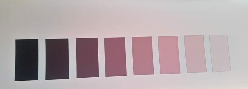

A little update , I'm posting 2 pictures.

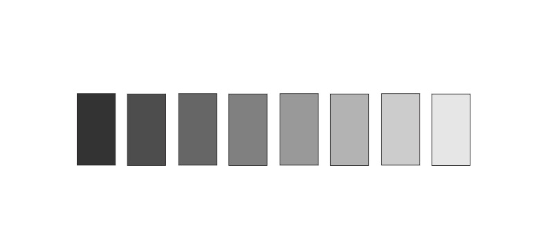

Here is a picture of what I selected in Corel X7 to print . The next picture is the result .
Remember , this was PERFECT with no issue just a few months ago .. so I'm baffled .

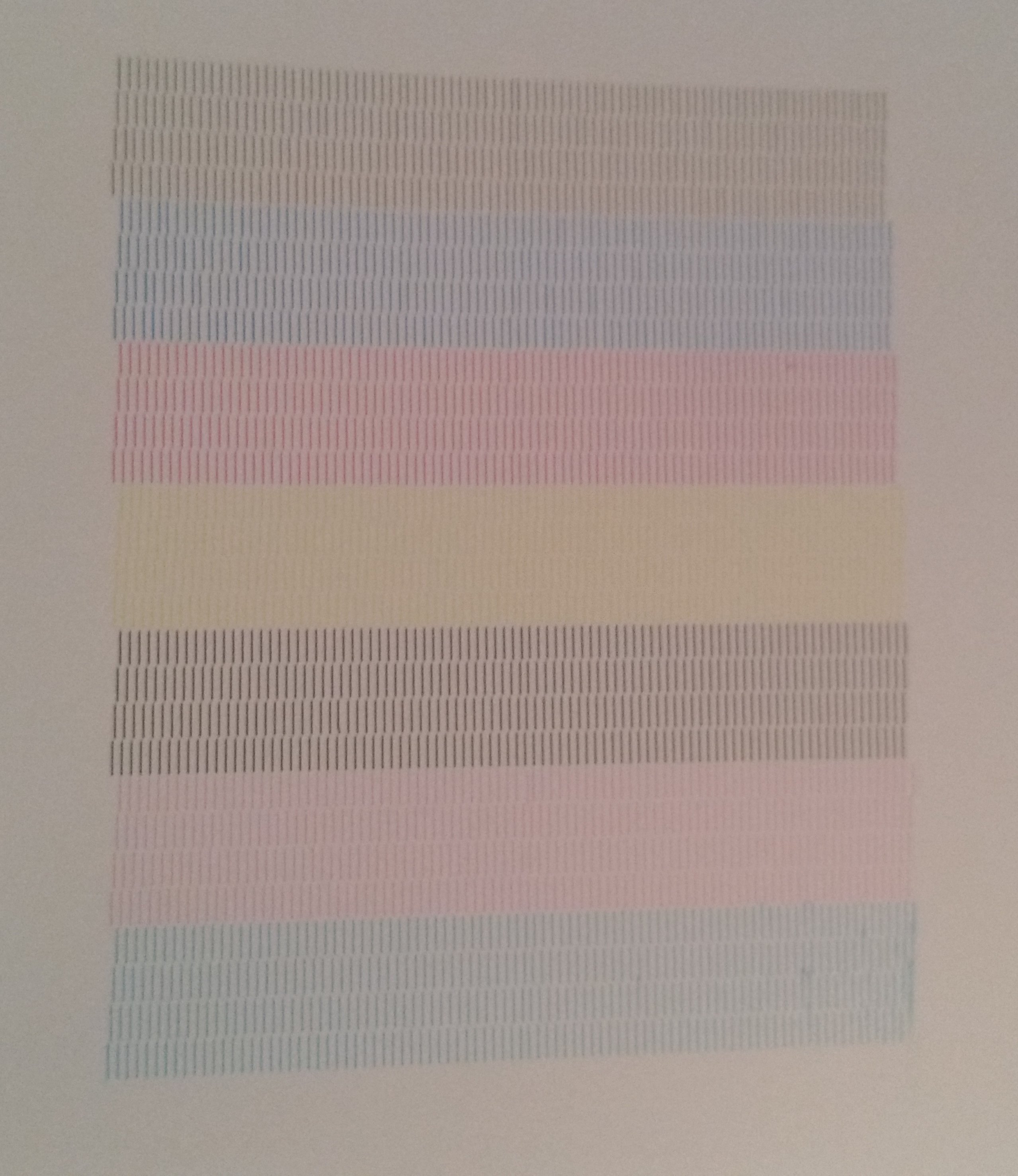

Check all of your ink cartridges manually by pulling them out of the machine and shaking them and feeling if they are empty, one may be empty and the machine isn't telling you so. A test print that's dropped out (not printing in one whole section) will confirm this as well.

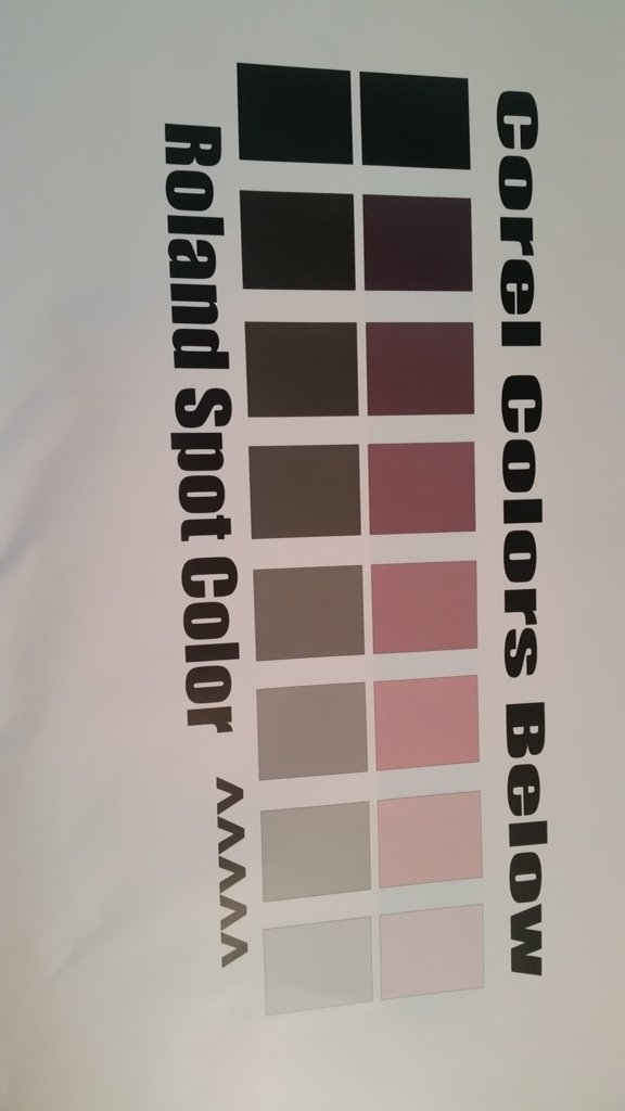

print-test.jpg color-test.jpg Test print was done and all is fine ( From what I can see ) Second picture shows all Roland colors are perfect .. But these are spot colors so it wont help me with gradients .

I am sure you already have a linearization. Re-linearization is what you want to do. If creating new output profile then you want to do a new linearization.

The simple answer is, profiles don't last forever. Even if you haven't changed anything, wear and tear on the machine cause profiles to "drift." Since there's nothing mechanically wrong (evidenced by your nozzle prints being fine), then the most likely culprit is the profile/linearization is outdated.

The gray samples you posted are just different percentages of grays not a gray to white gradient. The gray percentage samples looked to be off in the midtones. So I think you need to explain why you now say "Printing GRAY is no issue". Are referring to process gray verses black channel only grays?
