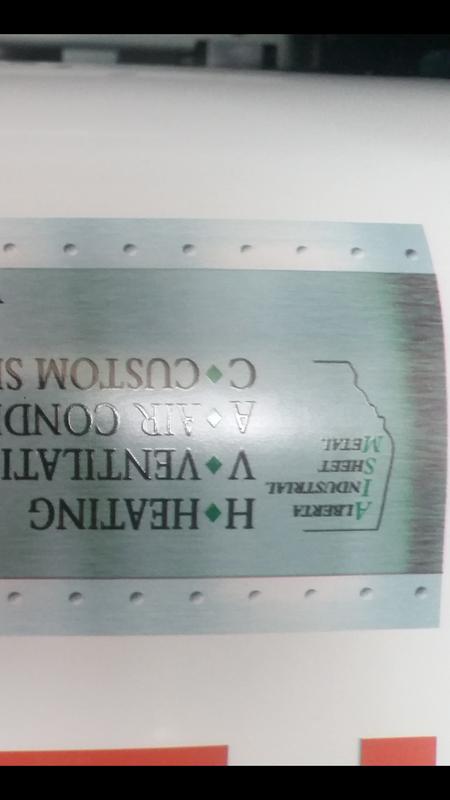

So this has only happen on this print. For some reason it has a green tint. All other prints are perfect. Roland sc540 soljet2 ex. Using colorip. Has anyone seen this

A photo of the print and screenshot of the art file would be helpful.
If you are comfortable with it, I can look at the file even.
Does Colorip convert spot colors to an equivilant CMYK color? If not, that could be an issue

see image, i tried to attach yesterday but didnt work
