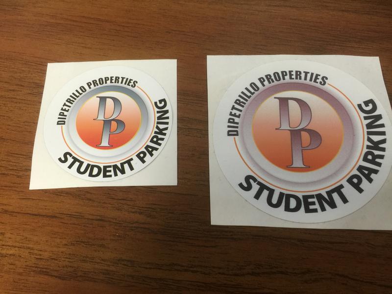

Our Roland XC-540 no longer can print grey.
Here is the file we are trying to print. Attached is what it looked like 2 years ago compared to now.
Same exact print file just dragged into versa works. File was created in Illustrator.

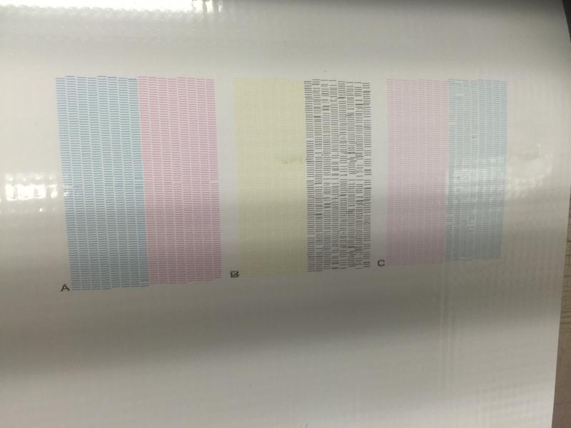

MikePro
its a profile issue and/or printhead alingment issue.
quick fix: try printing with ICC profiles turned off.
