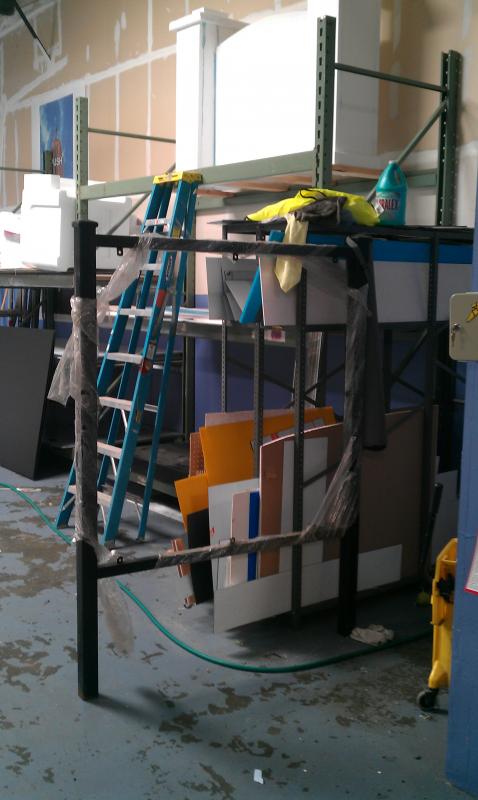

Have you considered fabricating a nice metal frame? You can use 3mm dibond with this, make sure there's tabs.
Here's one we have.
