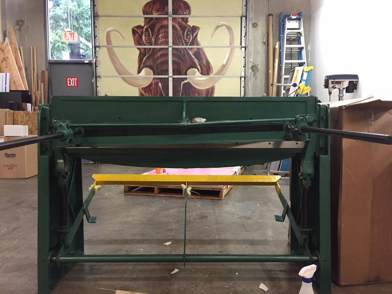

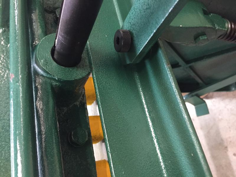

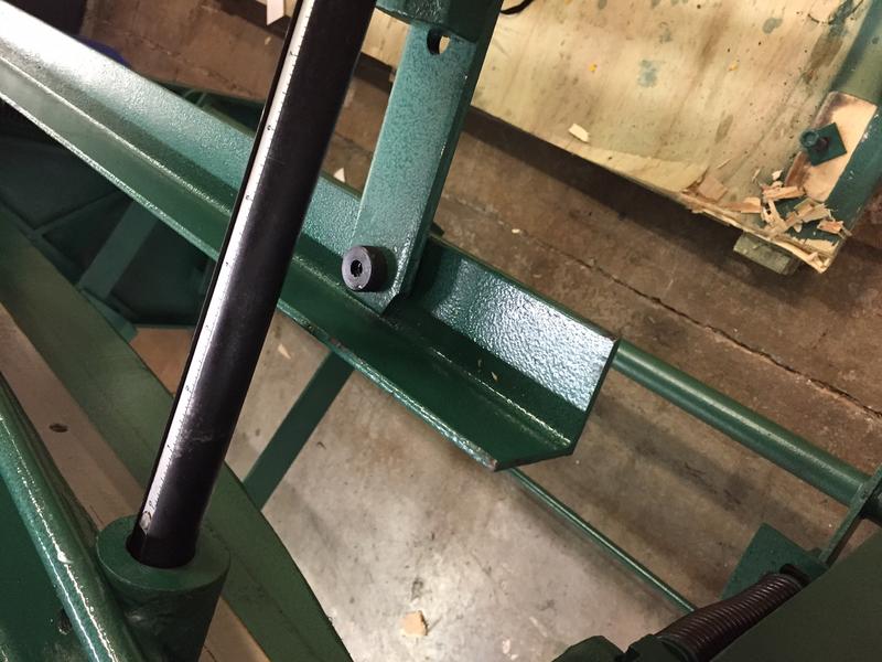

So I picked up a Grizzly shear for cutting aluminum, ACM, and others. I picked this model based on several reviews here. We unloaded easily enough (having a forklift is key there) and got the crate broke down. I was first a little surprised by the amount of cosmoline/grease on the piece. The first test cuts came out slathered in it.
I also couldn't figure out the backstop. When assembled like the instructions, the piece would shoot straight through and complete miss the stop (high). Looking back there, the stop was about 1" low on the left and just barely missing on the right. I don't know why it isn't level (granted this is our first shear purchase, maybe it's by design).
I was forced to flip it to get it to work (see image), but doing so make it hit the mounts on the machine, making so cutting less than about 3" using the stop wouldn't work. I also noticed that while one side of the stop has a threaded nut welded to it for mounting, the other was just a hole, and a separate nut.
Thinking I just got something messed up, hoping someone can take a look and help.

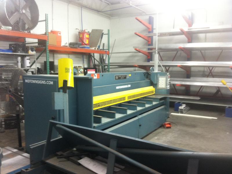

AaronSSsignsKC
Yep here ya go we just got this about 3 months ago!!! It has been an amazing change no stomping on any pedals any more!!!!
