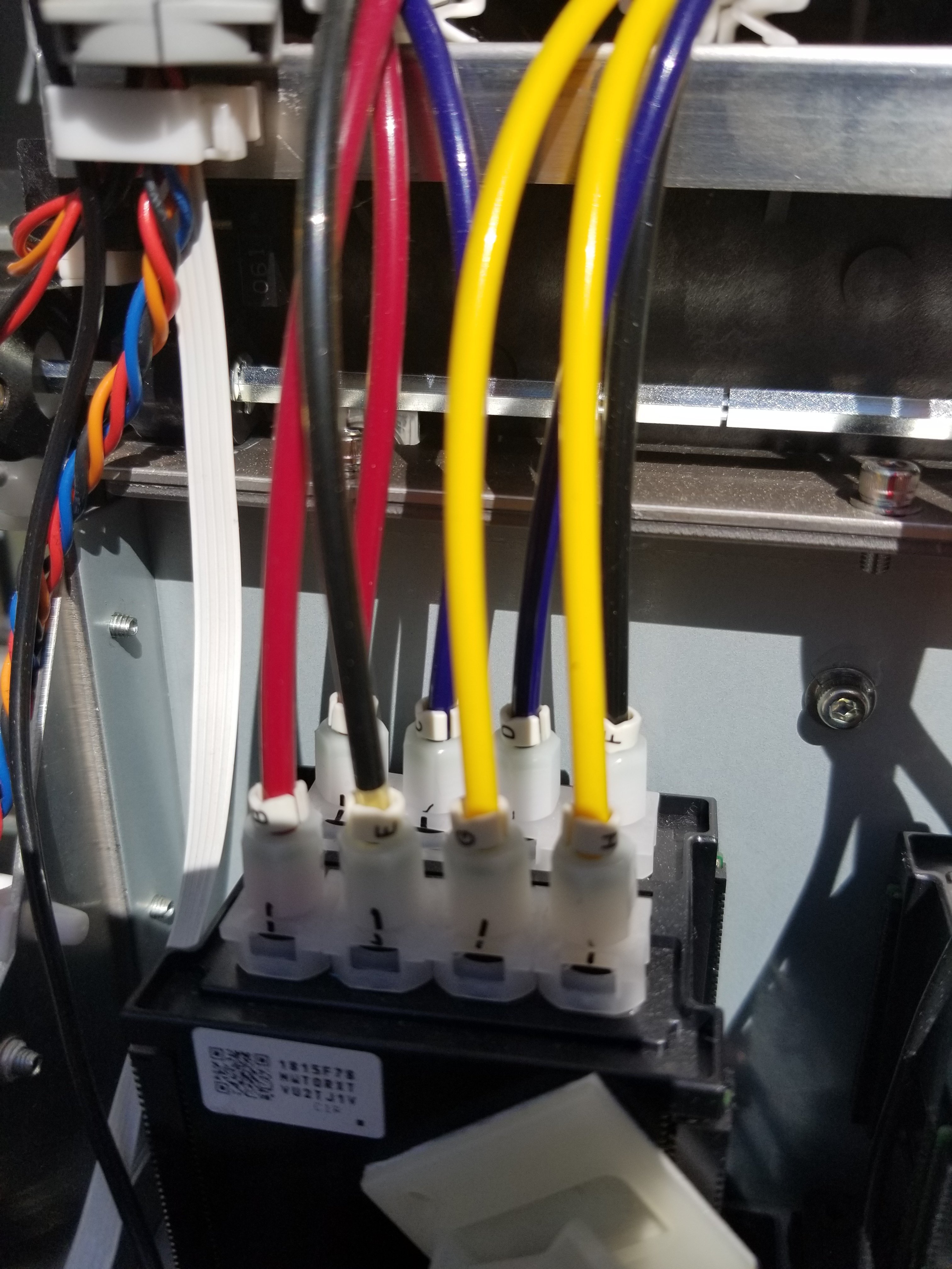

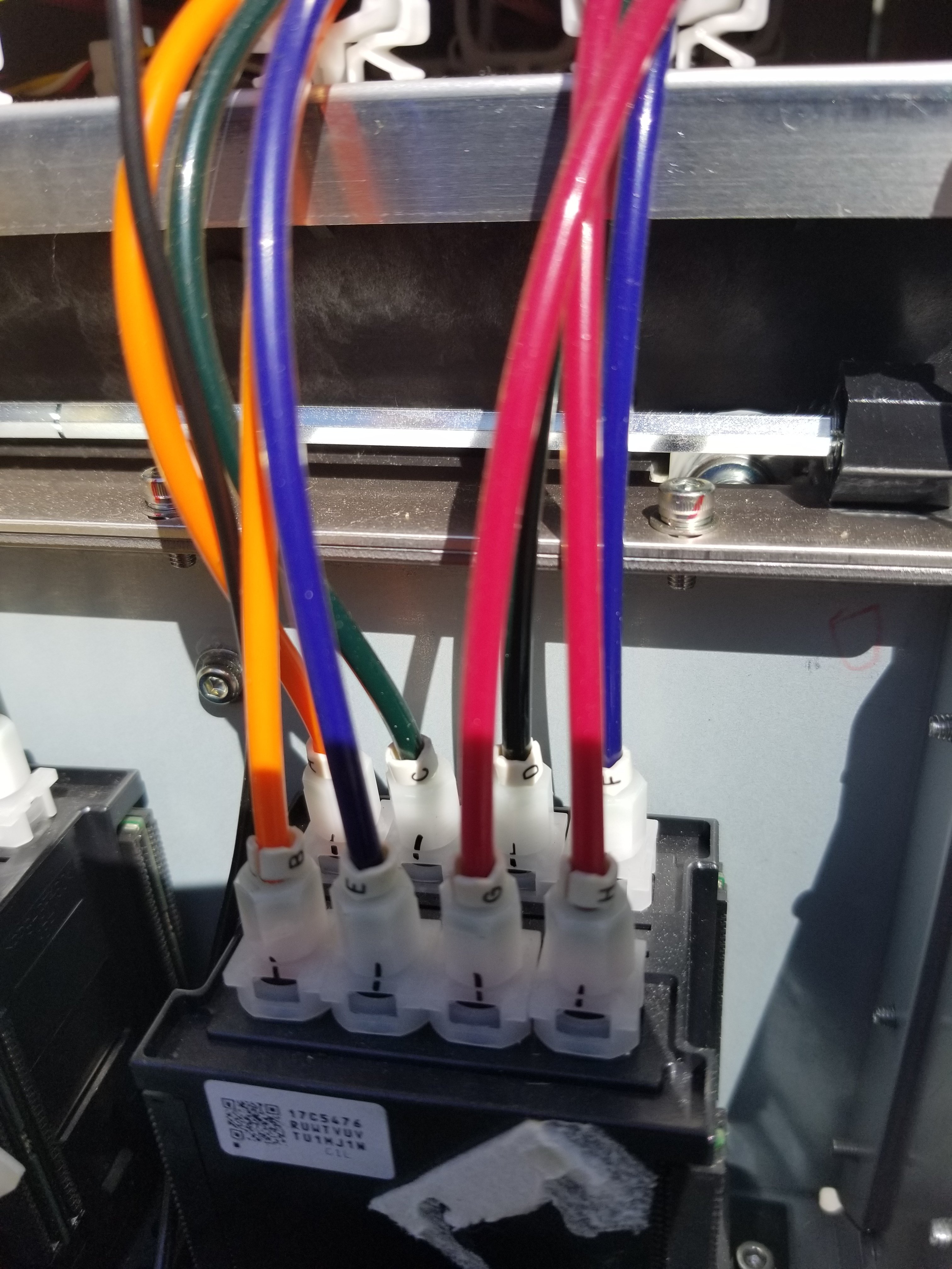

We have discovered that the Ink Tubes going into the Dampers are possibly in the wrong locations. Does anyone have a diagram or photo of their correct positions for each Color & Tube ? I have the Manual but it does not show them. i am working on the Left Side Print Head.
morty87
