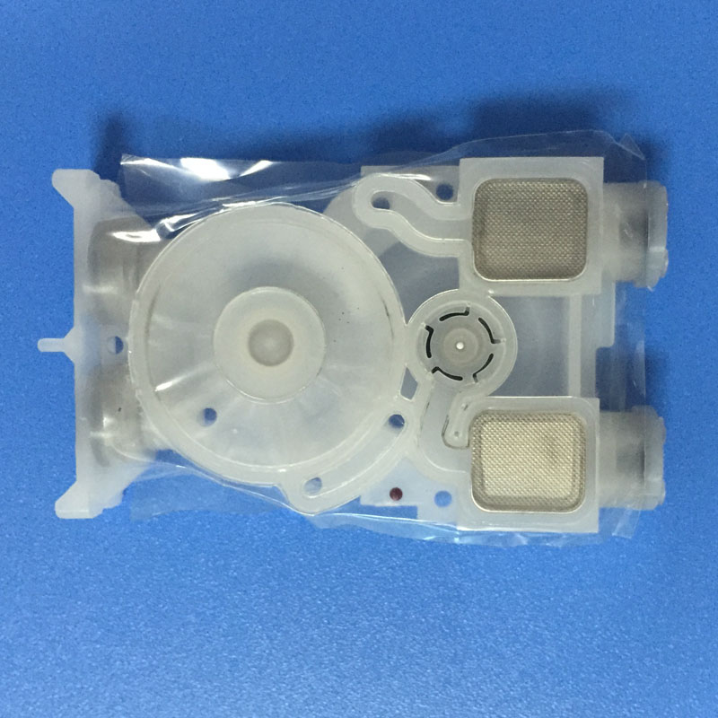

filter? where? this printer does not have any filter in the lines, you said that if you leave the printer for several hours the ink comes back again... the filter is the problem... remove it or if you are talking about the dampers then change damper, this printer uses dx7 head and two dampers per color, the dampers has the filters that the line needs to protect the printhead (attached pic) just identify the black lines and the dampers and change both... be carful this printhead is very delicate and if you disconnect cables or move you can blow out fuses from the mainboard
  • Original-dx7-head-damper-for-roland-VS-RE-RA-XF-FH-540-640-740-Printer.jpg
