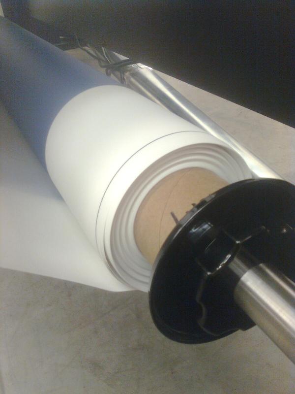

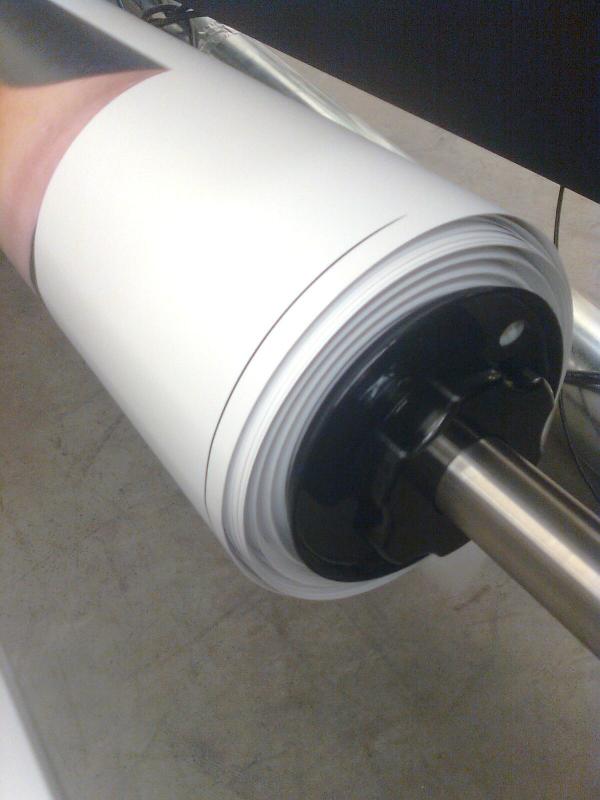

We got our GS6000, back in November, the take up hasn't taken up straight since. Epson refuses to sent out a tech, because they don't feel there is anything wrong with the printer. Our dealer said their hands are tied and all service calls have to go through Epson.
The belt broke last week (less then 3 months!!!!) and we had a tech out to fix it and he had no idea how to fix the problem with the take up motor.
I've scanned older post and made sure the platten and then tension bar are perfectly level. We tape the media to the take up core "by the book" cutting the corners of the media. I've been running Mimaki's for the last 7 years and never had this problem.
Were do I go from here???

Been running our GS6000 for close to a year now. Take up is not as nice as our Mimakis, but the print quality is so much better I live with it. I think most of it has to do with actually getting the media in the printer square as there is no tension on the media to help you do this. Sometimes the media takes up perfect but most the time it looks like your pics, but I think mostly because the media is not square.

We have it exactly paralell with the platen and it still walks back and forth. We have had this problem with this printer now for over 3 months and Epson refuses to get someone out here and fix it or show us what we are doing wrong.
