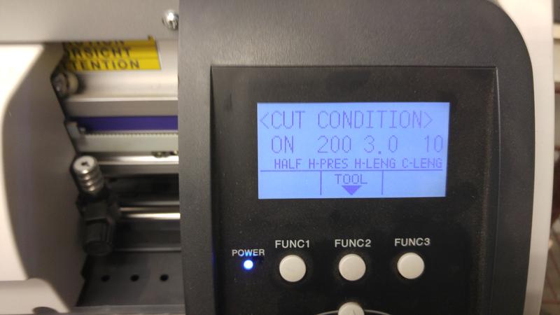

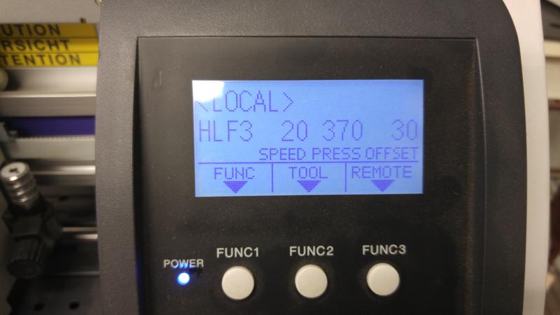

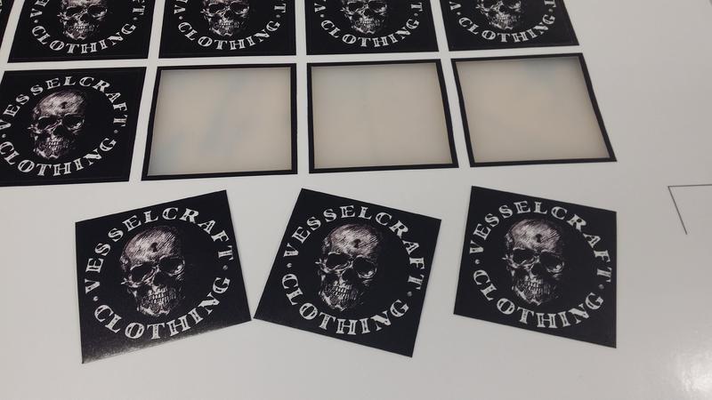

I do perf cut all the time and at around 250 3" x 3" at a time. I even perf cut 22" circles
i use a 45degree blade and I use the same blade and holder for cutting regular vinyl. No adjustments except the tool condition setting
Attached are pics of my settings and a recent perfcut sticker
